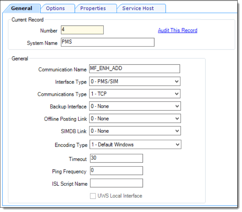

  4. On the General tab, configure the settings as follows:
    • Communication Name: Enter the name to use when communicating with the interface.
    • Interface Type: Select 0 - PMS/SIM.
    • Communication Type: Select the communication type that the interface uses.
    • Timeout: Enter 30.
    • Ping Frequency: Set to 0 (zero) to avoid double posting.
    Figure 43-6 Interface Module
    This figure shows the Interface module.

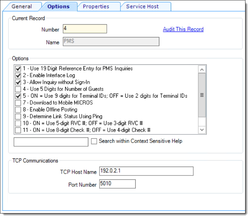

  5. Click the Options tab, and then select the options 1 - Use 19 Digit Reference Entry for PMS Inquiries, 2 - Enable Interface Log, 3 - Allow Inquiry without Sign-In, and 5 - ON = Use 9 digits for Terminal IDs; OFF= Use 2 digits for Terminal IDs.
    Do not enable option 8, as it causes double posting.
    Figure 43-7 Interface Module’s Options Tab
    This figure shows the Interface module’s Options tab.
  6. In the TCP Communications section, enter the following details:
    • TCP Host Name: Enter the OPERA PMS application server’s IP address or server name (if DNS is enabled).
    • Port Number: Enter the port number for the OPERA PMS server.

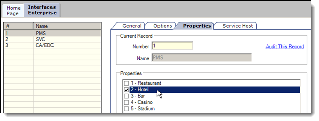

  7. Click the Properties tab, and then select the properties that can use this interface.
    Figure 43-8 Interface Module’s Properties Tab
    This figure shows the Interface module’s Properties tab.

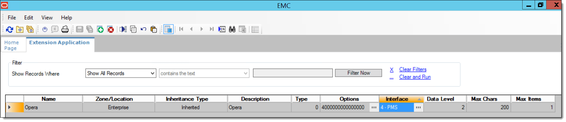

  10. Select the Enterprise, property, revenue center, or zone, click Setup, and then click Extension Application.
    This configuration typically occurs at the property level when the PMS interface is on-premise.
  11. In the Interface column corresponding to the OPERA extension application record, click the ellipsis point (...) button, and then select the PMS interface to associate it with the OPERA Extension Application record.
    Figure 43-9 Extension Application PMS Interface Assignment
    This figure shows the Extension Application module.
  12. Click Save.
