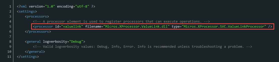

| Filename | Description |
ValueLinkProcessor.valuelink |
ValueLink Processor configuration. |
