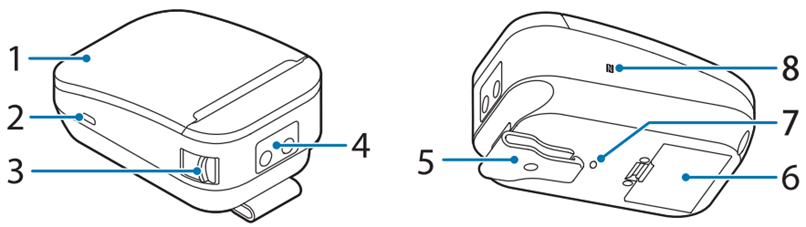

Epson TM-P80II Plus Basic Features
Figure 2-1 Epson TM-P80II Plus Basic Features
This image shows the TM-P80II Plus printer with numbers pointing to important printer features.
  1. Roll paper cover
  2. USB-C connector
  3. Cover open lever
  4. Operation panel
  5. Battery
  6. Wireless charging position
  7. NFC tag

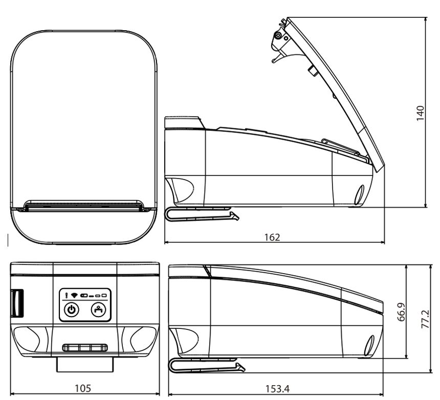

Printer Dimensions (Units:mm)
Figure 2-2 Epson TM-P80II Dimensions
This image shows the dimensions of the Epson TM-P80II.
