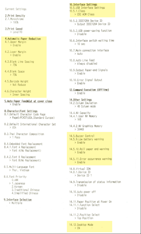

The TM-P80II has many settings that can be configured for individual preference. Because the paper capacity is limited, Oracle has changed some of the standard factory defaults to minimize paper use and be more Eco friendly. This provides a 71% increase in the number of checks per roll vs the standard factory default configuration. Standard factory defaults were also changed to improve battery life. The battery charging and operational limits were also changed. Listed below are the new settings from the factory. The complete list can be viewed in Epson’s Technical Reference Guide.
  1. Automatic Paper Reduction
    1. Upper Margin = Enable
    2. Lower Margin = Enable
    3. Blank Line Spacing = 75%
    4. Blank Space = 75%
    5. Character Height
      • >Inner Spacing  (75% reduction of inner spacing)
  2. CDC ACM Class = Enabled
  3. Buzzer Control
    1. Low battery warning = Enable
    2. Roll paper end warning = Enable
    3. Error Occurrence warning = Enable
  4. Desktop Mode = On
  5. Battery Charge Mode: Mode 2 – Charging is performed when the remaining battery power drops to approximately 67%
  6. Operation Mode When the Battery is Low: Mode 2 – Printing stops when the remaining battery level falls below approximately 10%
Figure 3-2 Printer Default Settings Confirmation
This image shows the printer default settings confirmation receipt.
