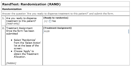

3 |
Generate form layout. |
For example: |
