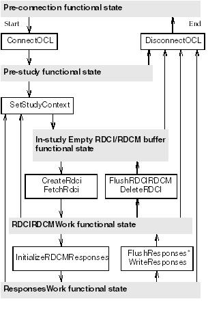

Functional State Transition Diagram
The following diagram illustrates the required transitions to move from one state to another in the API.
* If called with preserve lock, otherwise brings you to In-Study with Empty RDCIRDCM Buffer state.
Parent topic: Calling API Functions
