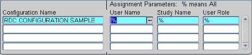

Modifying the Existing Assignments for a Configuration
By default, the system automatically assigns a newly-created configuration to all users, all studies, and all roles. Note that the User Name, Study Name, and User Role fields are set to the percent sign (%) wildcard, which is the default value and means ALL.
After you create a new configuration, you should modify the default assignments.

- Place the cursor on the row of the configuration you want to modify. Enter and execute a query, if necessary, to search for a subset of configurations.
- Select the Assignment Parameters fields to modify.
- Click the List of Values button or press F9 to view a list of valid values for the selected field. Use the Find field, if necessary, to search for a subset of the values.
- Select an appropriate value from the list.
- Click OK to insert the value into the parameter field.
- Save your changes.

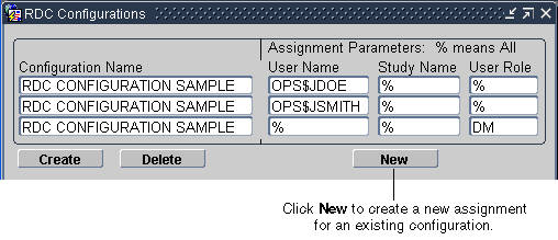

Creating New Assignments for an Existing Configuration
Creating new assignments lets you assign the same configuration to different sets of users.
Recall that you can make more than one assignment to a configuration. The configuration uses the same name and the same settings, but the assignment parameters are different for each instance of the configuration.
For example, suppose you create the RDC CONFIGURATION SAMPLE and define the settings for that configuration. You now want to assign that configuration of settings to JDOE, JSMITH, and all data managers. You click the New button to create a new set of assignment parameters.
For each new assignment that you create, the system inserts another instance (row) of the original configuration into the Configuration Name list and sets all the assignment parameters to the default value (that is, %). You can then change the assignment parameters for that instance.
If a configuration has multiple assignments, the configuration is listed multiple times on the RDC Configurations form. Note, however, that as you move from row to row of the same configuration, the values for the configuration settings are the same. The settings apply to the configuration. Changes you make to the settings apply to all users assigned to the configuration.
Before you can specify new assignments for an existing configuration, at least one of the assignment parameters associated with the existing configuration must be set to a non-default value (that is, cannot be set to the % sign).To specify new assignment parameters for an existing configuration:

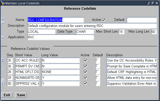

RDC Configurations in the Oracle Clinical Reference Local Codelists
When you create a new RDC configuration, the system also creates a new local reference codelist in Oracle Clinical. The local codelist has the following name:
RDC CONFIGURATION identifier, where identifier is the unique text string you entered in the Create New Configuration dialog box.
The local codelist has the same configuration settings as the RDC Configurations form. You can update the settings in either location.
