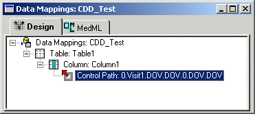

To create the table column definition and control mapping definition in the Data Mappings window:
  1. Right-click the name of the table in which you want to create a new column.
  2. From the pop-up menu, choose New Column.

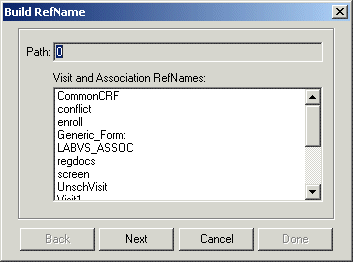

    The Build RefName dialog box appears.
  3. For each component of the RefName path, select the component from the list in the dialog box. To specify that you want the control to be mapped from all visits in which it occurs, select Generic_Form as the visit RefName.
  4. Click Next, or, to backtrack to a previous component, click Back.
    The InForm Architect application builds the path from your selections and displays it in the Path field at the top of the dialog box.
  5. When the RefName path is complete, click Done.
    The InForm Architect application inserts the path into the component definition you are creating.
  6. Repeat this procedure as often as necessary to create additional column mappings for the child controls of group controls such as radio buttons. To view control path properties for any path, click the path in the Data Mappings window.
