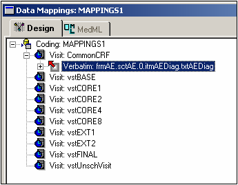

- In the Trial Objects window, double-click the name of the coding mapping object.
The Data Mappings window opens with the mapping object name selected.
- Expand the Visit node to expose the verbatim control mapping you want to remove.
- Right-click the node for the verbatim control mapping, and select Remove Verbatim from the right-click menu.
The InForm Architect application removes the verbatim control mapping definition.
