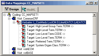

- In the Trial Objects window, double-click the name of the coding mapping object.
The Data Mappings window opens with the mapping object name selected.

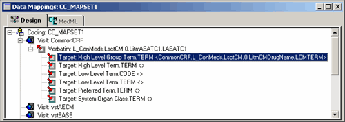

- In the Data Mappings tree, expand the Verbatim node.
- Right-click the Target to which you want to map a form control, and select Set Target Path from the right-click menu.
The Build RefName dialog box appears.
- Use the Build RefName dialog box to specify the RefName path. For more information, see General instructions for using the Build RefName tool.
- When the RefName path is complete, click Done.
The InForm Architect application enforces restrictions on code target control path definition. For more information, see Code target control path restrictions. If the selected control results in a valid code target control path, the InForm Architect application inserts or replaces the code target control path in the Target node.
