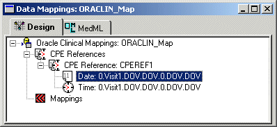

To define a CPE Reference date, right-click the Date node in the Data Mappings window. Select a command in the popup menu based on whether how you want to define the date:

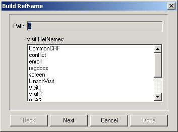

- Select InForm Path.
The Build RefName dialog box appears.
- For each component of the RefName path, select the component from the list in the dialog box.
- Click Next, or, to backtrack to a previous component, click Back.
The InForm Architect application builds the path from your selections and displays it in the Path field at the top of the dialog box.
- When the RefName path is complete, click Done.
The InForm Architect application inserts the path into the component definition you are creating.

The InForm Architect application updates the Data Mappings window with the date you selected.
