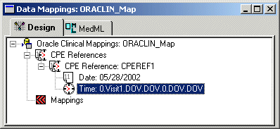

To define a CPE Reference time, right-click the Time node. Select a command in the popup menu based on whether how you want to define the date:

The InForm Architect application updates the Data Mappings window with the time you selected.
