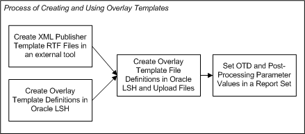

Creating Overlay Templates
About Overlay Templates
Oracle LSH's postprocessing feature uses Oracle XML Publisher to generate a single- or multi-volume PDF-format Report Set with a unified Table of Contents from the individual PDF reports and narratives generated by the first stage of Report Set execution.
To use the postprocessing feature, you must design and create RTF templates that can include graphics, watermarks, hyperlinks, text variables, and the font styles and sizes you prefer.
You create template files in Microsoft Word or a similar tool, save them as RTF files, and upload each one to an Overlay Template Definition (OTD) File definition in an OTD. In the OTD File definition you specify the file's orientation, paper size, language, and rotation.
For information on creating template files, see the Oracle XML Publisher User's Guide, which is available on My Oracle Support and the Oracle Technology Network.

Creating Template Files
Oracle recommends creating a single OTD containing all the template files you may need to postprocess a single Report Set. Decide which options represented by Post-Processing Parameters you want to support—A4 and/or US Letter-sized paper, landscape and/or portrait orientation— and create the template files necessary to support them in a single OTD. The values for the Post-Processing Parameters can be set in the Report Set definition, in the Execution Setup definition, or by a user submitting the Report Set for execution. Oracle LSH selects the template(s) to use for each section of the Report Set based on these Parameter values at runtime.

Setting Overlay Template Parameter Values
Oracle LSH Overlay Template definitions (OTDs) are designed to include all the template files you need to postprocess a Report Set; see Creating Overlay Templates. If you define your OTDs that way and this particular Report Set has no unusual characteristics, you can simply enter the name of the OTD in the Default OTD Parameter at the Report Set level and that value is propagated to all other OTD Parameters throughout the Report Set.
The value is displayed only where it is explicitly set.
However, if you need to use a different OTD for certain Report Set Entries or for certain Narratives or report outputs, you can do so. See Setting Overlay Template Parameters.
The Report Set itself and Report Set Entries have a similar set of Overlay Template Parameters:
