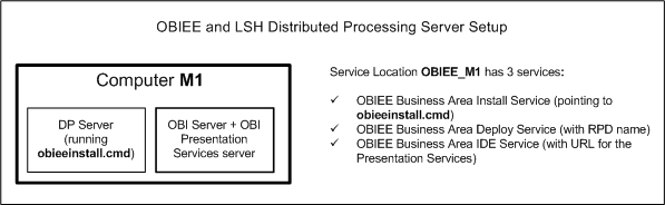

Setting Up a Single-Computer Configuration
In Oracle Life Sciences Data Hub you must define a service location for the BI Server computer.
See Defining Service Locations. Figure 11-1 shows the setup of a single-computer configuration.
You must define all three OBIEE Services for the service location; see Defining Services for more detailed instructions.
- OBIEE Business Area Install Service. In the Execution Command field of this service, enter the path of the obieeinstall.cmd script; for example:
C:\LSH_DP_SERVER\obiee\obieeinstall.cmd
.Note:
If you are using OBIEE 10g, the file names have "10g" appended: obieeinstall10g.cmd and obieedeploy10g.cmdNote:
During installation this script should have been copied into the DP Server Home directory or a subdirectory of it. - OBIEE Business Area Deploy Service. In the Execution Command field of this service, enter the path of the obieedeploy.cmd script; for example:
C:\LSH_DP_SERVER\obiee\obieedeploy.cmd
.In the Details field, enter database connection information and the name of the .rpd file you want to use on the Oracle BI Presentation Server; for example:
dsn=abc123,callinterface=OCI10G,RPD=LSH_MASTER
. If you are using OBIEE 11g, addver=11g
. - OBIEE Business Area IDE Service. In the Execution Command field, enter the URL of the Oracle BI Presentation Server.; for example:
http://
svr:port
/analytics/saw.dll?Answers
For the OBIEE IDE Service, specify a number of Service Instances equal to the maximum number of users you expect to query the repository at the same time, plus a buffer; see Service Instances.If you do not create enough service instances, users may lose access to the database in the middle of a task. For example, if you define 10 service instances and 11 people log in to the same OBIEE URL, when the last person logs in, the system looks for a session that has been running longer than the defined Reuse Wait time for the service. If there is such a session, the system recycles it even if the user is active, and the original user loses his or her connection to the database.
It is better to solve this problem by defining a large number of service instances than a high reuse wait time because the same user cannot open a new session—for example, if he or she wants to select different launch settings—until his or her original session reaches the reuse wait time.

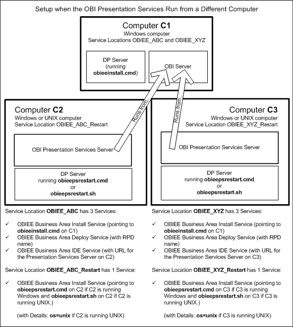

Setting Up a Multiple-Computer Configuration
If you want to install the Oracle BI Presentation Server on a UNIX machine or additional Windows machine, install just the Oracle BI Presentation Server and the Oracle Life Sciences Data Hub DP Server on the second machine (without the Oracle BI Server).
You can choose to have either a single, merged .rpd file or a different one for each Presentation Service instance. In either case, multiple Business Areas can use the same Presentation Server.
Define a pair of service locations for each Presentation Server computer: one on the Presentation Services computer ending in _RESTART
and one on the BI Server computer with the same name except without the _RESTART
string; see Defining Service Locations.
Edit the DP Server Start script on each computer with the exact name you give the service location. Instructions are in the Oracle Life Sciences Data Hub Installation Guide.
Do not use spaces, slashes, or special characters such as single quotes (') in the service location name. This may cause problems when you define a remote location and connection to password-protect the .rpd file.Figure 11-2 Multiple-Computer Setup
Description of "Figure 11-2 Multiple-Computer Setup"
- Service Locations and Services Required in a Multiple Computer Installation
In Oracle Life Sciences Data Hub you must define a pair of service locations, one with services running on the BI Server computer and the other with services running on the Presentation Services computer, for each separate Presentation Services computer. - Single and Multiple Repository Files
OBIEE repository (.rpd) files reside on the BI Server. The Business Area meta-data and OBIEE Administration Tool logic for all Business Areas that use a particular Presentation Server are merged into a single .rpd file.
This section contains the following topic:
- Service Location Name
The name of the service location for the Presentation Services computer must be the same as the corresponding service location for the BI Server plus the string_RESTART
Parent topic: Setting Up a Multiple-Computer Configuration
The name of the service location for the Presentation Services computer must be the same as the corresponding service location for the BI Server plus the string _RESTART
When Definers create a new OBIEE Business Area, they must select a service location to use. The drop-down list displays all OBIEE service locations that do not end in _RESTART
For example, as shown in Figure 11-2, the service location and service requirements when the BI Server and Presentation Server are on different computers are:
- Give the first service location, which must be for a Windows computer, a name such as
OBIEE_ABC
and define all three OBIEE services for it:- OBIEE Business Area Install Service. In the Execution Command field of this service, enter the complete directory path and filename for the Windows execution command script on the BI Server computer; for example :
C:\LSH_DP_SERVER\obiee\obieeinstall10g.cmd
. - OBIEE Business Area Deploy Service. In the Execution Command field of this service, enter the complete directory path and filename for the Windows execution command script on the BI Server computer; for example :
.In the Details field, enter database connection information and the name of the .rpd file you have defined for the Oracle BI Presentation Server; for example:dsn=ilpcr211,callinterface=OCI10G,RPD=Study02
- OBIEE Business Area IDE Service. In the Execution Command field of this service, enter the Presentation Services URL, for example:
http://C2:9704/analytics/saw.dll?Answers
- Give the second service location, which can be for either a Windows or UNIX computer, a name that is the same as the first service location plus the string
_RESTART
; for example,OBIEE_ABC_RESTART
. Define one service for this service location: the OBIEE Business Area Install Service.- In the Execution Command field of this service, enter the complete directory path of the correct restart (not install) execution command script for the operating system; for example, on Windows:
C:\LSH_DP_SERVER\obiee\obieerestart10g.cmd
or on UNIX:
/slot/ems1/appmgr/lshdpserver/obiee/obieepsrestart10g.sh
- If the Presentation Server is a UNIX computer, enter
os=unix
in the Details field of this service.
In a multiple-computer configuration you can also use the Presentation Server that is installed by default on the same computer as the BI Server. In this case you need one more service location defined the same way as for a single-computer configuration; see Setting Up a Single-Computer Configuration.

Using Separate URLs to Control Access
Each (presentation server URLs) Presentation Server must be installed on a different computer and has a different URL.
You can use this setup to control what users can see in OBIEE. For example:
- If you have only one Business Area using a particular Presentation Server, users launching OBIEE with that URL can see only the Subject Area that corresponds to that Business Area. You can include the Subject Area in the URL so that users go directly to the Subject Area page; for example:
http://
srv:port
/analytics/saw.dll?Answers&SubjectArea=X
- You can organize your Business Areas so that only related Business Areas use the same Presentation Server; for example, all studies in a single project have a Business Area, and there is another Business Area for the project as a whole. Users launching OBIEE with that URL can see only the Subject Areas related to that project, and can see data only for the Subject Areas that correspond to Business Areas on which they have View privileges.
Parent topic: Security Configuration
