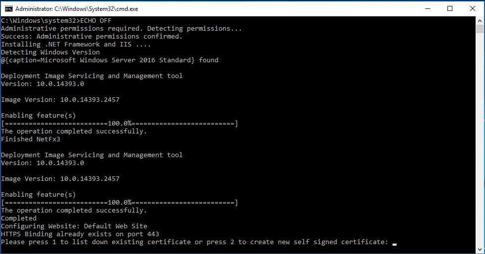

Run the Install.bat file as administrator located at
\FMS Web Applications Enablement\ Install.batof the downloaded software. -
Installation commences with the registration of .NET and enabling the IIS. Once IIS is enabled, Hyper Text Transfer Protocol Secure (HTTPS) binding is created on port 443 and Hyper Text Transfer Protocol (HTTP) Binding is deleted on port 80.

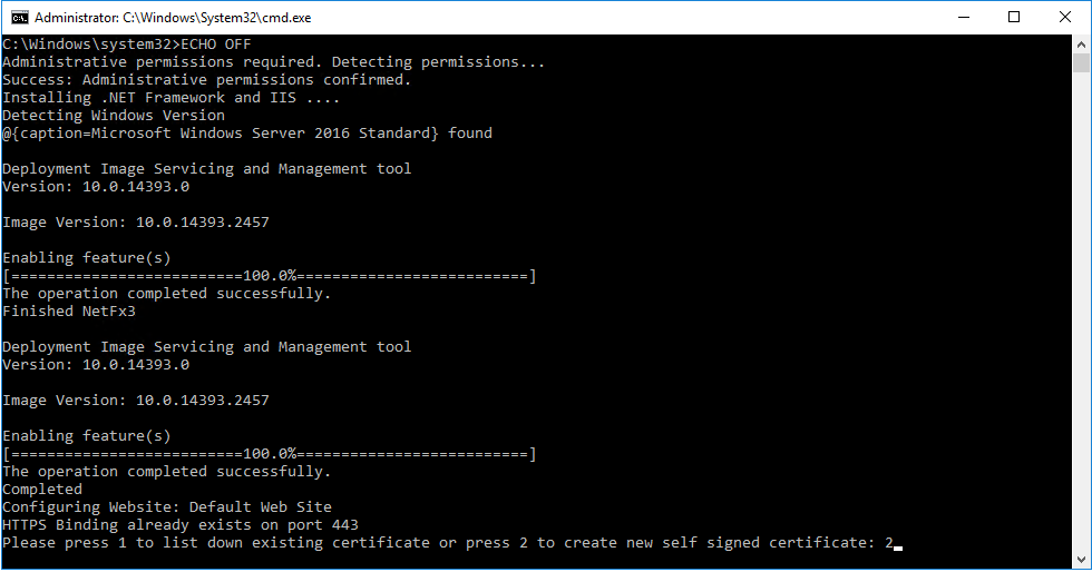

Process to bind certificate starts. The screen will prompt you to “Please press 1 to list down existing certificate or press 2 to create new self-signed certificate”

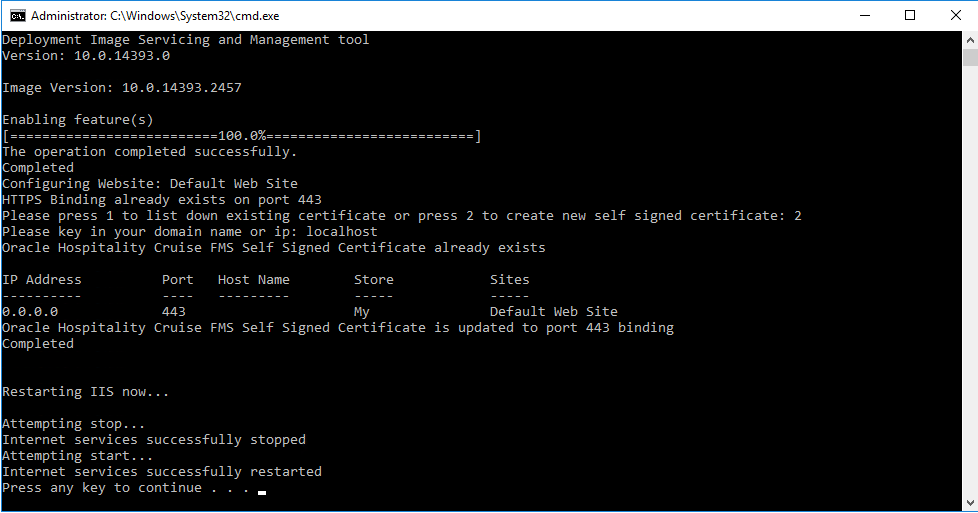

Enter 2 and you are prompted to enter the domain or the Internet Protocol (IP) address.
Figure 5-4 Domain or Internet Protocol Address Entry
Figure 5-5 Self-signed Certificate Created
IIS restarts when the self-signed certificate is created and bound to port 443.
