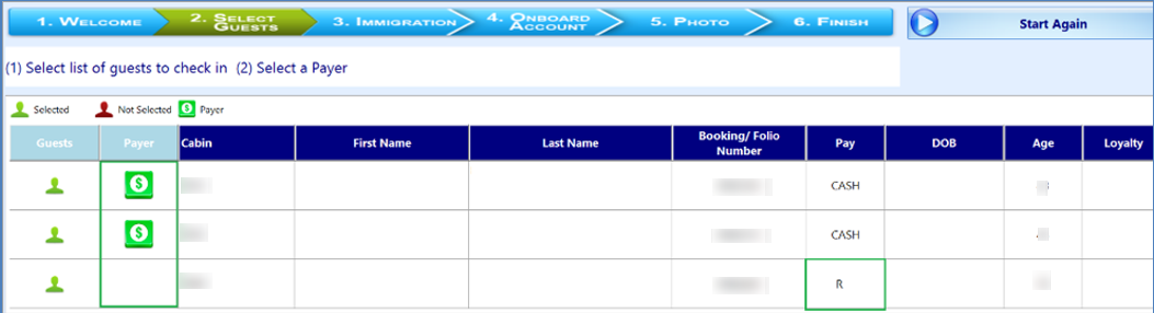

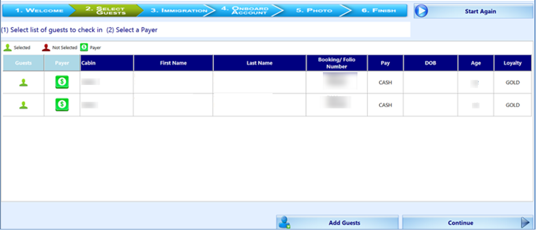

Selecting a Guest
The Select Guests screen is the second of the six processes in CIW. It displays the earlier searched guests that are due to embark, and below section describes the usage within the Select Guests screen.
Figure 5-2 CIW — Select Guests
Table 5-1 Select Guests Screen Field Definition
| Field Name | Descriptions |
Guest |
Indicates whether the guest account is selected or not, and by default it is shown as Selected. |
Payer |
Indicates whether the guest is a payer for the account. |
Cabin |
Displays the cabin number assigned. |
First Name |
First Name of the guest. |
Last Name |
Last Name of the guest. |
Booking/Folio Number |
Displays the guest booking number and is default to RES_BOARDCC_EXT field. The guest folio number is the user defined field, for example RES_ACC. |
Pay |
Displays the payment method use. |
DOB |
Displays the guest date of birth. |
Age |
Displays the age of the guest. |
Loyalty |
Displays the discount category entitled during the cruise. |
Selecting a Guest to Select/Deselect a guest account
To select/deselect the guest, click the icon in the Guest column. Multiple selection is permissible when selecting guests to check in.
Adding Guest to Check-In
Additional guest may be added to the selection list using the Add Guest function. Upon clicking the Add Guest, the system returns to the Welcome screen, enabling you to add a guest to the list, by repeating the earlier process.
Selecting/Deselecting a Payer
To deselect a payer from the guest account, click the Dollar icon in Payer column. This removes the icon from the column.
To select a payer for the account, click the blank space in the Payer column to turn on the Dollar icon.
If the account has a routing instructions, the payer account will have the Dollar icon in Payer column, and the payer column of the guest he/she is paying for will be blank and a letter R is shown in Pay column instead.
The system always process the first payer shown on the grid, and followed by a selection of payers account before it processes the non-payer account.
Figure 5-3 Payer Routing Selection

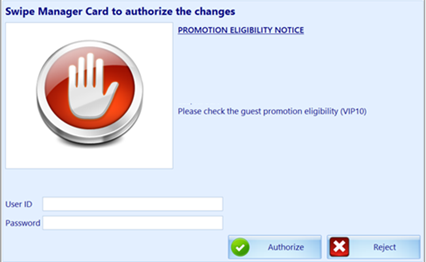

Promotion Eligibility
If the guest is entitled to a promotion, a Promotion Eligibility Notice will prompt, requesting for an Authorization from the user. If the sign-on user is assigned with the user security rights #4510 – Allow Authorize RCL Check-In Hard Stop, the user can immediately authorize/reject the eligibility. If the sign-on user does not have the above user security right, then further authorization from a supervisor level is required.
Figure 5-4 Promotion Eligibility Notice

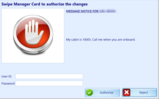

Guest Messages
The system prompts the following when there is a message waiting to be delivered to the guest. The Message Notice prompt is set off in Guest Message Delivery mode, 1 – Deliver at Advance ACI Wizard.

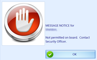

If the guest have undeliverable messages, a Message Notice shall prompt, requesting for an authorization to mark the message as delivered. If the sign-on user is assigned with the user security right #4510 – Allow Authorize RCL Check-In Hard Stop, the user can immediately authorize/reject delivery of the message.
If the sign-on user is a regular user, then further authorization from a supervisor level is required.
Figure 5-5 Guest Message Notification
If the message is a warning notice that prevents the guest from embarking, then check-in is prohibited.
Figure 5-6 Guest Message Warning Prompt

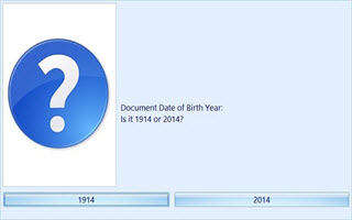

Date of Birth
Figure 5-7 Year Setting Affecting Travel Documents
- If the PC Regional Setting year is set to 2-digit year format, the system prompts for confirmation for the correct year. Select the correct year to update.

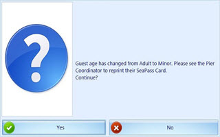

Figure 5-8 Year Setting Affecting Guest Age
If the changed date is within the minor age group or vice versa, you will receive another prompt requesting for SeaPass Card to be reprinted.

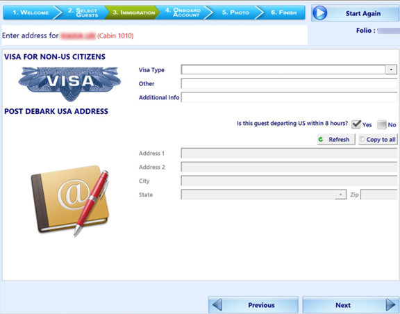

Adding Visa Information
On the Visa section, the required Visa Type is dependent on the Travel Rules Setup.
Figure 5-9 Visa Requirements
Table 5-3 Visa Screen Field Definition
Visa Type |
Field is editable or mandatory depends on the conditions defined in Travel Rules Setup. |
Other |
Free text field |
Additional Information |
Free text field |
Is this guest departing US within 8 hours?: Yes/ No |
Field is editable or mandatory depends on the conditions defined in Travel Rules Setup. By default, Yes is checked. |
Refresh |
Button reset the screen to default selection. |
Copy to All |
Function copies inputted number to other guests if multiple guest is chosen. |
Address 1 / 2, City, State and Zip |
Field editable when the user select ‘NO’ at ‘Is this guest departing US within 8 hours?’. Zip code must not be less than 5 digits. |
Entering Visa Information
Select from the drop-down list the type of Visa.
Use the Other field to enter the Visa Number and Additional Info field for other information.
Entering Post Debark US Address
On the ‘Is this guest departing US within 8 hours?’, select No.
Fill in the US Address, City, State and Zip code.
Click Next to continue.

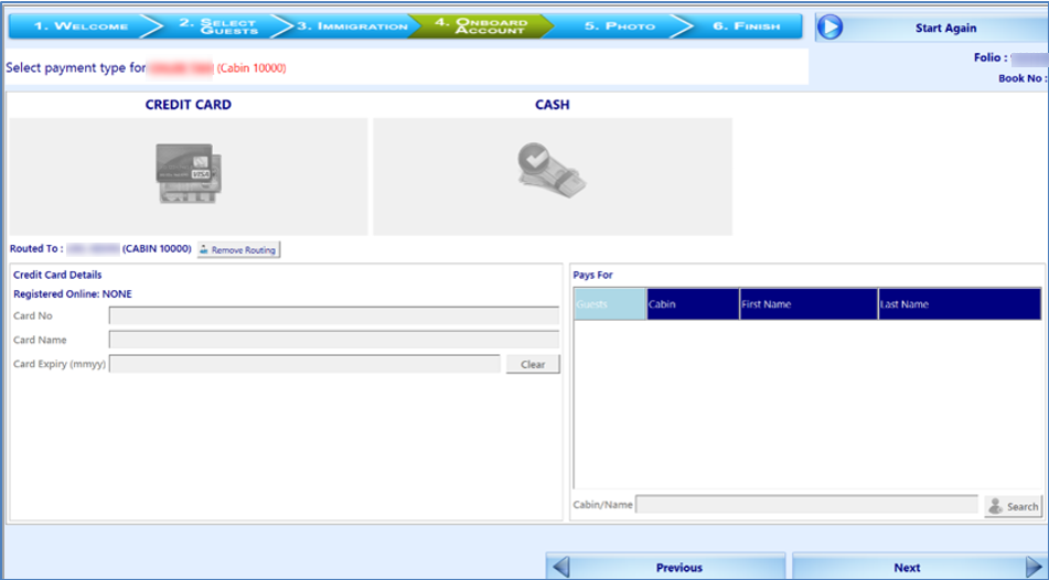

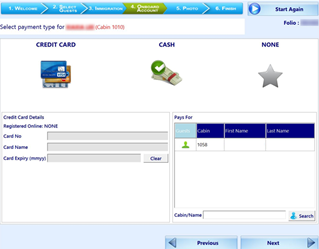

Onboard Account
The Onboard Account screen is the fourth of the six processes in CIW, and it stores the guest payment type, with the selected payment type indicated with a green checkmark on the icon.
Payment type can be easily changed by clicking on the image.
If the guest has a registered credit card, the card details are displayed below the card section with its credit card number being masked.
It also permits you to route an account to the guest.
Figure 5-10 Onboard Account
Updating the Credit Card Details
To update or swipe the card for details,
Click the Credit Card image.
Swipe the credit card on the reader, or manually enter the credit card number, name and expiry date.
Clicking Clear will reset the information entered.

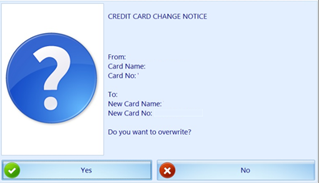

If the card name or credit card number registered online differ from the card, the system will prompt a Change Notice.
Figure 5-11 Credit Card Change Notice
Click Yes to overwrite the information with the latest, or No to retain current information and disable previously registered credit card. If the credit card is registered twice, you will be prompted with message “This credit card is already registered in the system. Please use another credit card”.
The above validation requires parameter ‘General’,’Check Credit Card Registration’=1

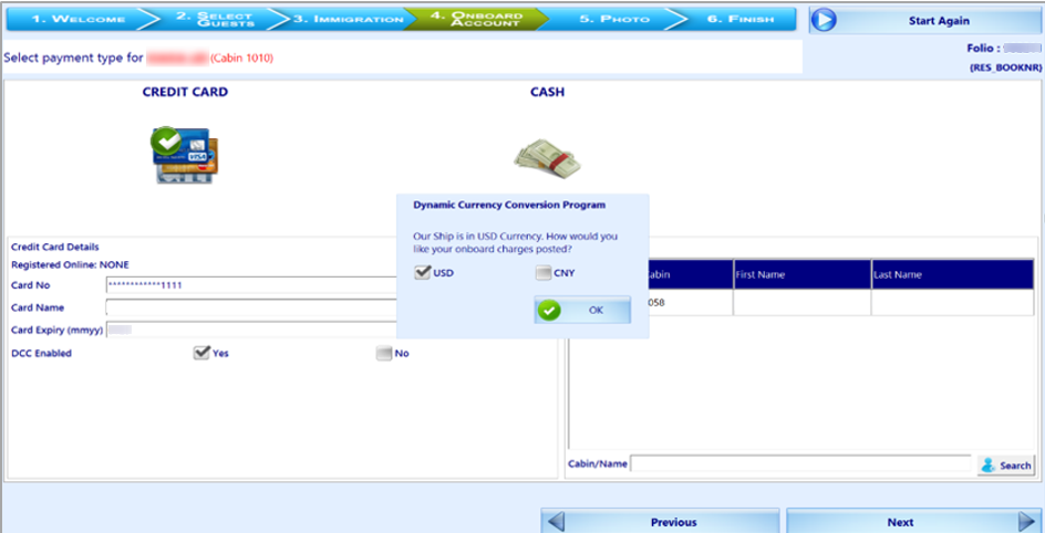

Dynamic Currency Conversion (DCC) Handling
The Check-In Wizard supports Dynamic Currency Conversion (DCC) as part of the credit card payment type. When the guest uses a foreign based credit card, they have an option to choose whether to use the home base currency or dynamic currencies during settlement. This handling requires parameters ‘General’, ‘Enable Credit Card DCC’=1 and ‘General’, ’DCC Base Country’=NULL, and default the ‘DCC Enabled’ to Yes.
To opt in a settlement using Dynamic Currency Conversion
Swipe the credit card through the card reader or manually enter the credit card number, name and expiry date, and click Next.
By default, the Ship currency is checked. Select a Currency Type when prompt, and click OK to save.
Selecting Other Payment Type
Click the Cash image to select.
Click Save to save the changes.
Click the None image. This sets off a prompt, “You have selected NONE as payment method, do you want to continue?”.
Click Yes to proceed to the next step, or click No to return the current screen.
Figure 5-12 DCC Handling
Routing Assignment
The Routing function is enabled when the current selected guest is the payer.
On the Onboard Account screen Pays for section, search the buyer’s last name or cabin number.
On the searched list, click the Guest column to select the account, and this changes the color from red to green.
Click Save to save the routing.
If more than one guest is selected in Select Guests screen, the system returns to the Immigration screen automatically, allowing you to complete the next guest information and payment option.
Figure 5-13 Onboard Account Routing

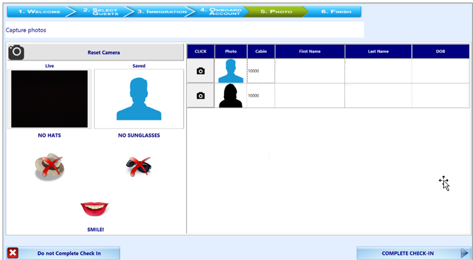

The Photo screen is the fifth of the six processes in CIW. It stores a copy of the guest photo captured with the live camera attached to the PC. This function requires parameter, ‘Quick Check In’, ‘Take Photo Before Checkin’=1.
With the above parameter, taking a picture is mandatory before you can proceed to the next step when a camera is detected to be working, and you will be prompt with message ‘Guest photo must be taken before you can continue’. If no camera is detected, or the camera is not working, then photo taking it is not required.
Saving Live Photo to Guest account
At the guest list, click the Camera icon under Click column of the guest you wish to capture the photo. Photo taken is displayed in the Saved column.
To retake the picture, repeat step 1.
If the camera becomes non-responsive, click the Reset Camera
Click Complete Check-In to save the photo and you will be navigated to the Finish screen with lists all successfully checked-in guests shown on screen.
Figure 5-14 Photo Screen
