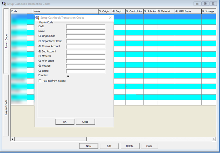

Setting Up Transaction Codes
  1. At the Cashbook context menu, select Setup Transaction Codes.
  2. To add Pay-In Transactions Code, select the Pay-in Code tab and click New.
    Figure 2-1 Cashbook Transaction Codes
    This figure shows the Cashbook Transaction Codes
  3. At the Pay-In code form, Code and Name field, insert a unique transaction code.
  4. You can randomly create the Transactions code as it has an option to link the code to its corresponding general ledger account.
  5. By default, the Enabled checkbox is checked. Deselect the check mark to deactivate the code.
  6. Check the Pay-Out/Pay-In code checkbox to duplicate the code to Pay-Out, or vice versa. This option depends on the Parameter setting “Same Pay-In/Out Codes”.
  7. To delete the Transactions Code, select the code and click the Remove button. You are not allowed to delete a code that transaction linked.
  8. To edit the details, click Edit.
