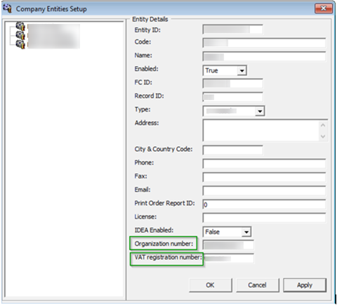

Company Details
You must set up the Company entities for the company information to be shown on the report.
Figure 2-1 Company Entities Setup
Login to the Administration module and select Administration, System Setup.
Select Company Entities Setup and enter the value for two new entities as follows:
Organization number: Organization number from Register Centre or other relevant government authority.
VAT registration number: The Company’s VAT number. This is the unique number from Register Centre.

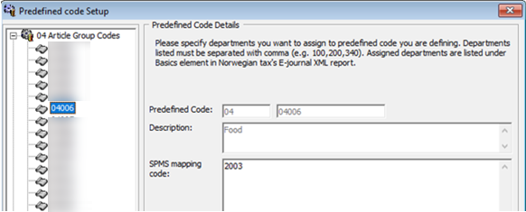

Standard Predefined Code 04 — Article Group/Department Codes
Figure 2-2 Sample Predefined Article Group
This code is used to configure the system debit department code. In below screen example, the system debit department code 2003 for food is mapped to standard predefined code 04 and predefined ID 04006.
On the report, this standard predefined code is displayed
in <basicType>
and <predefinedBasicID>
under <basics>
element.

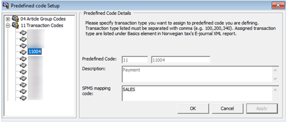

Standard Predefined Code 11 – Transaction Codes
This code is used to configure the system transaction code. The payment transaction code SALES is mapped to standard predefined code 11 and predefined ID 11004 as shown in below figure.
Figure 2-3 Sample Predefined Transaction Codes
There are two categories of transaction code in the system:
Transaction code for Point-of-Sales (POS) record. This is displayed
in <lineType>
under <ctLine>
element on report. There are five types of transaction code for
POS record. You must follow the exact system
transaction code per below and configure it into user interface to
avoid unmapped data and incorrect information being displayed.
POST (add posting)
SALES (payment)
REFUND (return payment)
DIS (discount)
VOID (void posting)
Transaction code for receipt type. This is displayed in <transType>
under <cashtransaction>
element on report. There are four types of transaction code for
receipt type. You must follow the exact system transaction code below
to configure into user interface.
SALES (Sales Receipt)
RETURN (Return Receipt)
PROFORMA (Pro Forma Receipt)
DELIVERY (Delivery Receipt)

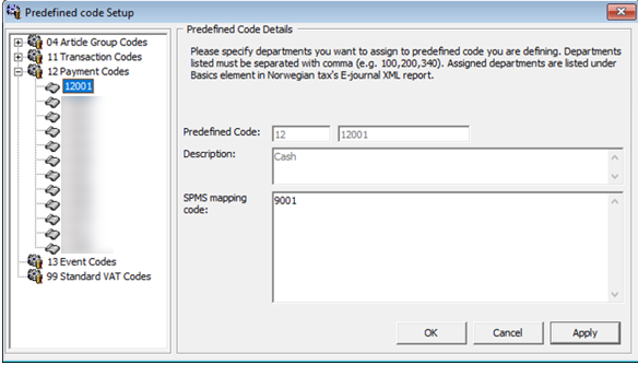

Standard Predefined Code 12 — Payment Codes
Figure 2-4 Sample Predefined Payment Codes
This code is used to configure system credit department code or payment code. In below example, the credit department code 9001 for cash is mapped to standard predefined code 12 and predefined ID 12001.
This is displayed in<basicType>
under <basics>
element on report.

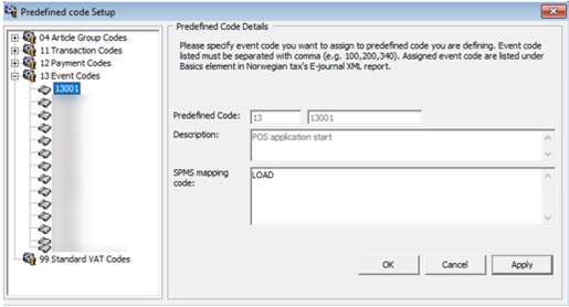

Standard Predefined Code 13 — Event Codes
Figure 2-5 Sample Predefined Event Codes
This code is used to configure system event code. In below example, the system event code LOAD for application starting is mapped to standard predefined code 13 and predefined ID 13001.
This is displayed in <event>
under <cashregister>
element on report.

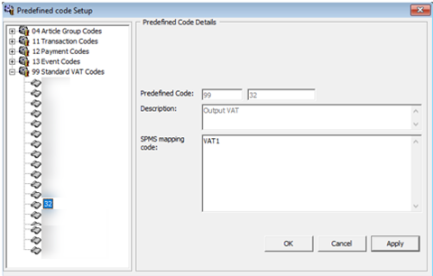

Standard Predefined Code 99 – Standard VAT Codes
Figure 2-6 Sample Predefined VAT Codes
This code is used to configure system VAT code. In below example, the system VAT code VAT1 is mapped to standard predefined code 99 and predefined ID 32.
This is
displayed in <standardVatCode>
under <vatCodeDetails>
element on report.

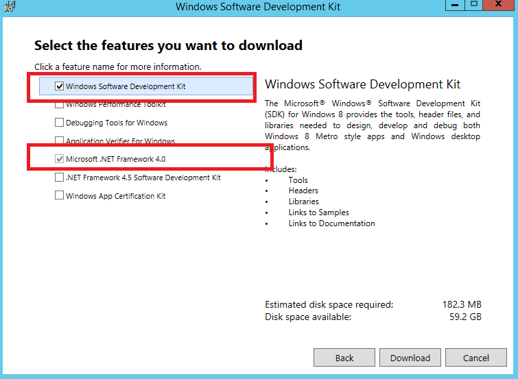

This method is recommended if the target machine is Windows 10 and Windows Server 2012. Download and install the Windows 10 SDK from: https://developer.microsoft.com/en-us/windows/downloads/sdk-archive.
Start the installation and choose the option as shown in below figure.
Figure 2-7 Windows Software Development Kit Options

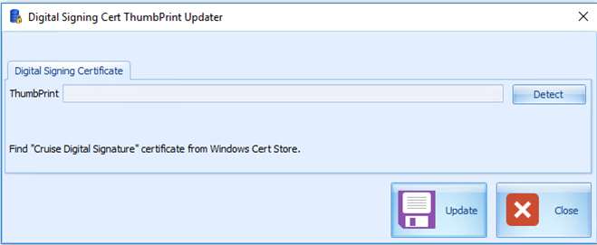

Managing the Key Version in SPMS
Although the key pair is stored in the Windows certificate store, SPMS will need to manage the key version. Every new key pair used in SPMS will be recorded in KEY table of SPMS schema.
Login to OHC Tools module.
At the ribbon bar, click the Update Cert ThumbPrint.
At the Digital Signing Certificate window, click Detect for program to look up the certificate name < CERTIFICATE NAME>" and obtain the ThumbPrint of the public key.
Figure 2-9 Digital Signing Cert Thumbprint Updater
Click Update to store the key into the KEY table.
