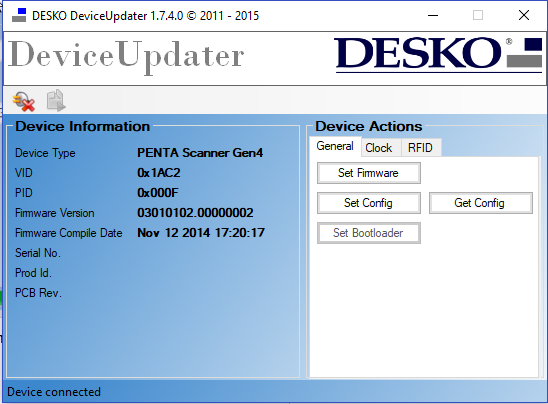

The update tool automatically scans for installed devices and prompts a message for every Desko device detected.
Figure 5-3 Device Information Page

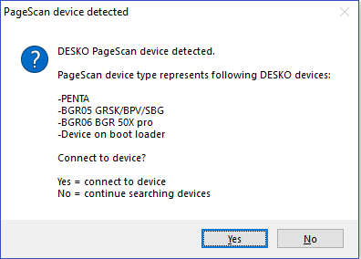

At thePageScan device detected window, click Yes to connect the device.
Figure 5-4 DESKO PageScan Device Detected
You can also scan for devices manually by clicking Connect button from the Device Updater window. In the DeviceUpdater window, the following options are available to connect the device:
Firmware Update: Updates the firmware by selecting the firmware file (.ldr) from an open dialog window.
Configuration Update: Updates the configuration by clicking Set Config.Select the configuration (.xml) file from an open dialog window.
Process Desko Device update package: Updates using a device update package (.dup) file.
