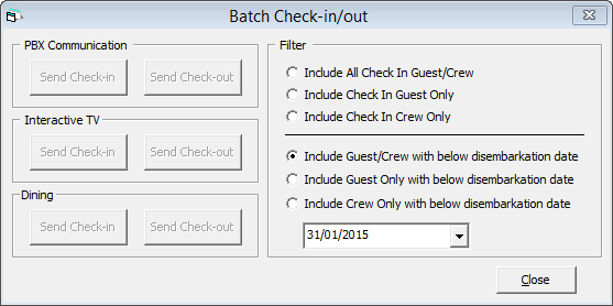

Batch Check-In/Out
The Batch Check-In/Out function allows you to send triggers by batch to enable/disable the Telephone, ITV, or Dining System.
Figure 8-2 Batch Check In/Out Window
Table 8-1 Batch Check-In/Out Filters
Field Name | Description |
Include All Check In Guest/Crew |
Sends triggers for all check-in/out for all guest. |
Include Check In Guest Only |
Sends triggers for check in/out guest only. |
Include Check In Crew Only |
Sends triggers for check in/out crew only. |
Include Guest/Crew with below disembarkation date |
Sends triggers for check/out guest/crew with specified disembarkation date. |
Include Guest Only with below disembarkation date |
Sends triggers for check/out guest with specified disembarkation date. |
Include Crew Only with below disembarkation date |
Sends triggers for check/out crew with specified disembarkation date. |
From the Stateroom Setup menu, select Batch Check-In/Out.
Select from the available filter and select a Date.
Select the type of batch to execute.
Click Close to exit.

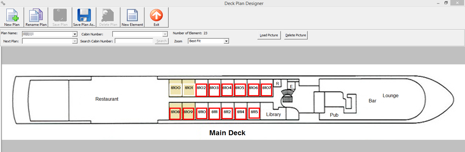

Deck Plan Designer
Figure 8-4 Deck Plan Setup
- Select the Deck Plan Designer from the Stateroom Setup menu.
- Click New Plan and insert the Plan name.
- Click Load Picture to load the base plan from file.
- Click New Element and then drag the element box to the desired location.
- Select the Cabin Number from drop-down list, then click the element box to assign the cabin.
- Repeat steps 4 and 5 until all cabin numbers for the deck are assigned.
- Click Save Plan to save the changes.
Editing a Deck Plan
- From the Deck Plan Designer window, right-click the element you wish to edit.
- Select the option from the menu.
Linking a Plan
- Select a Plan Name to edit.
- Select the Next Plan from the drop-down list.
- Click New Element and place the element near a staircase of the diagram.
- Click Save Plan.
