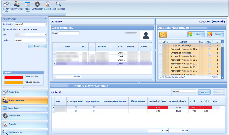

Time Approval Method in Crew Overview
Crew Members Search
Figure 5-1 Crew Overview in Time Approval Method
At the Crew Members Overview pane, select the Sub-Location, select the Year and Month, and then click Search.
At the Crew Members section, select the crew to display.
Enter either the crew Last name or external ID in the Search field to narrow down the search.
Roster Schedule
The Roster Schedule displays the crew monthly roster, enabling approval or disapproval of schedules. Creating and modifying of schedule is allowed in this function.

Below are the available fields in Crew Overview, Roster Schedule.
Table 5-1 Roster Schedule Field Description
| Field Name | Description |
Date |
Displays the scheduled date |
Crew Approved |
Schedules approved by Crew at T&A Terminal |
Mgr Approved |
Schedule approved by Manager |
MLC Violation |
Hours Worked (MLC). The label is configurable in Administration module, System Setup, Labels Setup, TATE17. |
ILO Violation |
The default label is ILO. The label is configurable in Administration, System Setup, Labels Setup, TATE17. |
Non-complaint Reason |
Approval reason for non-compliant schedule. |
Off Day Reason |
Approval reason for zero hours schedule. |
Hrs Worked (ILO) |
Total hours scheduled per day. The column is highlighted if the total hours scheduled exceeds the value set in Parameter, “Time Attendance”, ILO Maximum Work Hours in 24-hour period.” |
Hrs Worked (OT) |
Total hours scheduled for work codes that are flagged with “Include into Working hours”. |
Rest Hour Block 1 |
The biggest rest hour block. The column is highlighted as a violation if the total rest hour block is less than the value set in Parameter, “ILO Minimum Block Rest Hours in 24-hour period”. Available in Time Approval Mode. |
Rest Hour Block 2 |
The second biggest rest hour block. The column is highlighted as a violation if the total rest hours per day is less than the value set in Parameter, “ILO Minimum Block Rest Hours in 24-hour period”. Available in Time Approval Mode. |
Paid |
In Time Approval mode, this column is called Contracted. It indicates whether the worked hours have been paid in Payroll. |

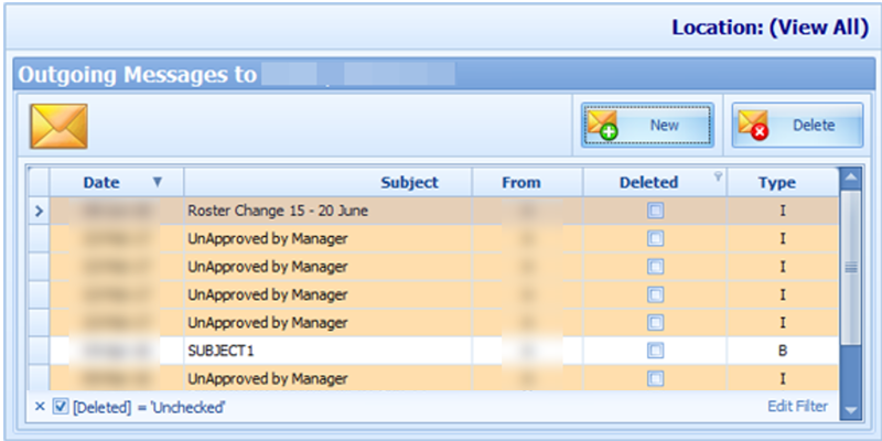

Messages
The Messages section displays all the crew messages whether it is read or unread. By default, the Delete filter is checked and deleted message are excluded from the list. To view the deleted messages, remove the filter.
I – Individual Message
B – Broadcast Message
Figure 5-3 Crew Messages
Creating a Message
In the Message section of the Crew Overview, click New or go to the Message tab and select New from the ribbon bar.
Enter the Subject, Priority Level and content of the message.
Click Send to send the message.
Click the Delete button to delete the selected message. You cannot delete messages created by other users, and deletion is only allowed if you are granted with privilege right #4472.

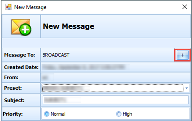

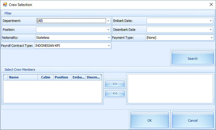

Creating a Broadcast Message
In the Message tab at the ribbon bar, select Broadcast.
Click the “+” sign at the MessageTo field to expand the Crew selection.
Figure 5-4 New Broadcast Message
Figure 5-5 Broadcast Message Selection
Select the Department, Position, Embark Date, and other required information from the drop-down list, and click Search.
Crew matching the criteria are listed in the Select Crew Members section. Select the crew name(s) and then click the right arrow.
Click OK to close the window and return to the New Message window.
At the New Message window, you can select a Preset message or enter your own, by inserting the Subject Line and message content.
Click Send to broadcast the message. The messages will prompt when the Recipient logs in to the Time and Attendance Terminal.

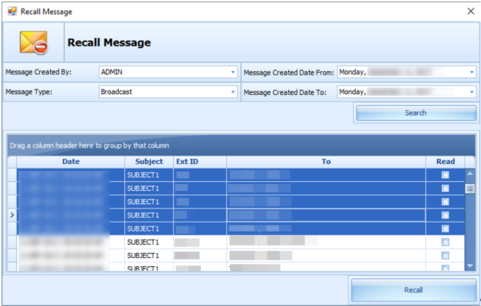

Recalling Message Broadcasted
You can recall messages that are sent accidentally. However, you cannot recall messages that are read.
Figure 5-6 Recall Message Form
Click the Recall button at the ribbon bar.
In the Recall Message window, select the Message Created By, Message Type, and Message Create Date From/To from the drop-down list, and click Search.
Select the message(s) to recall and then click the Recall button.
At the confirmation prompt, click Yes to confirm the message recall.

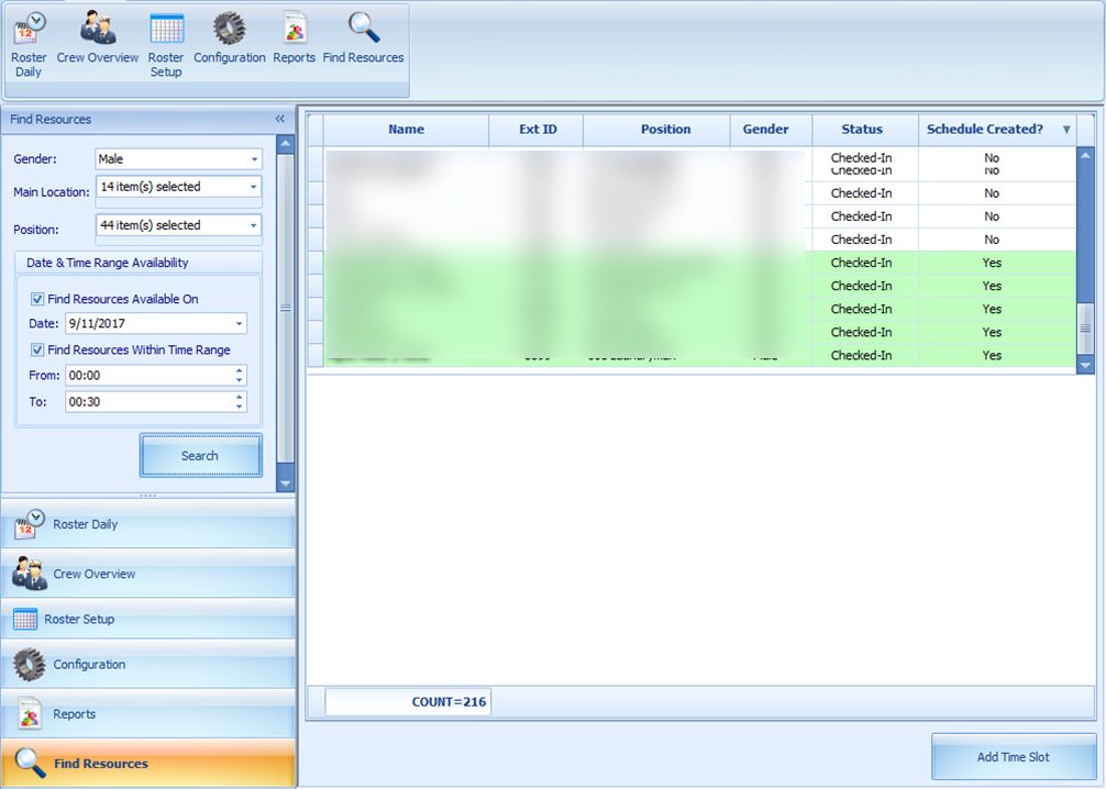

Find Resources
Figure 5-7 Find Resources Function
Click Find Resources from the ribbon bar.
Select the Gender, Location, Position, and Date/Time Range Availability from the drop-down list, and then click Search.
Results shown in the grid are non-violating ILO hours. Select the name of the crew from the results grid and then click the Add Time Slot. Note that you are only allowed to add time slot to the crew that has a schedule created.
In the Add Time Slot window, select the Roster Task from the drop-down list and then click OK to add.

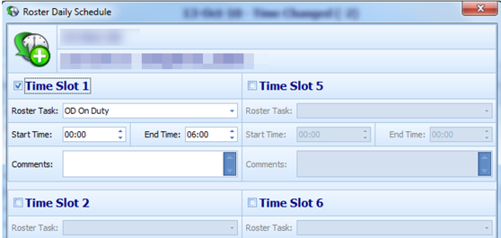

With the time zone set up, work hours are recalculated and the differences are reflected in the T&A module when the Roster Daily has a start/end time falls between the time zone changes. For example, on 13th October at 02:00 hours, the time zone changed and crew worked from 00:00 to 06:00 hours. Therefore the total worked hours shown is 8 hours, as illustrated in the figure below.
Figure 5-8 Roster Daily Schedule for Time Zone Change

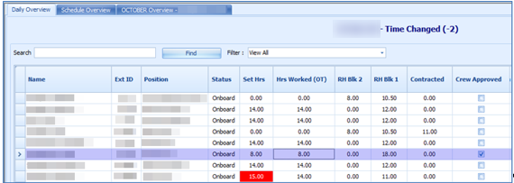

Figure 5-9 Recalculated Daily Hours in Time Zone Change
The above figure shows the recalculated “Daily Hours” of schedule that falls on a changed time zone.
At the T&A Terminal, the total hours calculated under the Approved Worked hours screen shows an 8 hours work, even though the start time is 00:00 and end time is 06:00.
