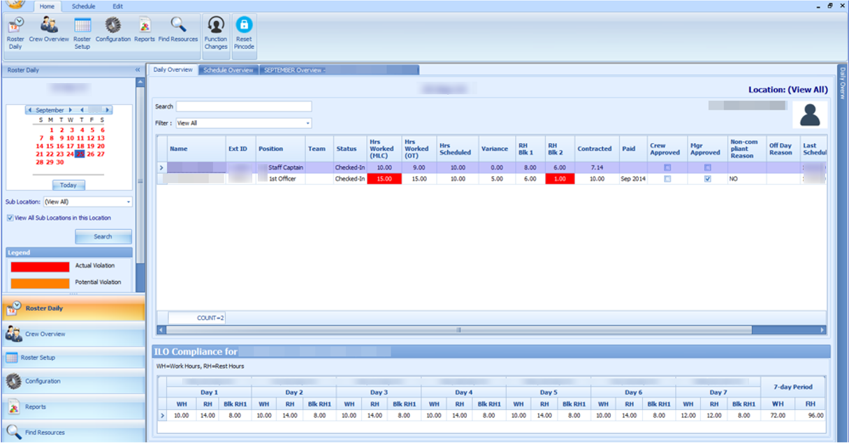

Daily Overview
Figure 4-1 Daily Overview in Time Approval Method
Table 4-1 Field Definition of Daily Overview Tab

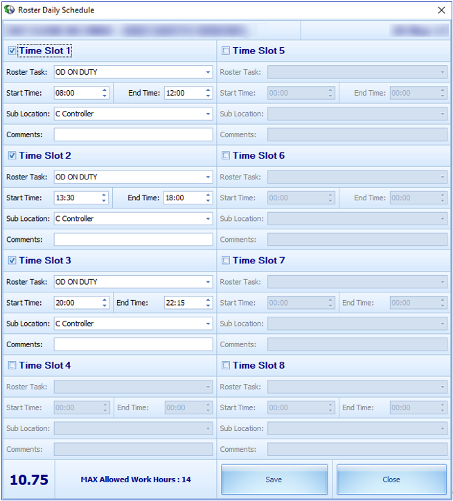

Select the date from the Calendar Editor in the Roster Daily.
Go to the Daily Overview tab and double-click the crew name to open the Roster Daily Schedule window.
Figure 4-2 Roster Daily Schedule
ILO Compliance
Figure 4-3 ILO Compliance in Daily Overview
At the ILO Compliance section, the system automatically sets the columns in red when daily worked/rest hours violates the ILO Regulation. The hours shown in Worked Hours (WH) and Rest Hours (RH) are the accumulated daily worked/rest hour.
Selecting a crew will display the total WH and RH for seven-day period in the ILO Compliance section.
Modifying Roster Daily Schedule
The system allows you to modify a roster schedule created from the template by removing or adding new time slots. You are not allowed to modify or delete the schedule if the Roster has been paid through payroll. This function is only accessible by users that are granted with access rights “#3292 – Allow to Create & Modify Roster Schedule”.
In the Roster Daily Schedule window, select the time slot checkbox, enter the roster task, start/end time, and the sub location, and click the Save button. See Figure 4-2

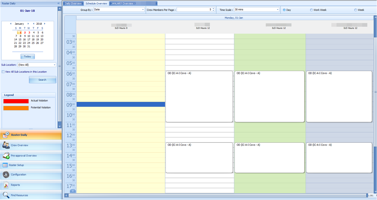

Schedule Overview
The Schedule Overview displays the crew schedules in a graph view, based on the following options and as shown in below figures.
Figure 4-4 Schedule Overview by Date
Figure 4-5 Schedule Overview by Crew Members
Date: Displays schedule by date.
Crew Member: Displays schedule by Crew Member.
Displays schedule with the number of members defined.
Day View: Displays schedule by day.
Work Week: Displays schedule by the work week.
Week: Displays schedule by week.
Month: Displays schedule by month.
Displays the hour in 15 or 30 minutes block.
Creating a Roster Schedule in Schedule Overview
A schedule can be added into the Schedule Overview tab using the drag and drop option or from a context menu.
Adding Schedule Using Context Menu
At the crew name, select the time slot from the grid.
Right-click to open the context menu.
Select the task to add the schedule. This creates the bar graph in the Overview tab.
Adding Schedule Using Time Slot
At the hour grid of the crew, double-click to open the Time Slot window.
Select the Roster Task, Sub-Location from the drop-down list and insert a comment, if any.
Select the Start and End Time for the task.
Click OK to save. The system prompts:
An ILO Violation if the schedule hours is more than the allowed ILO hours per day
An Overlapping of Time Slots warning if the schedule is overlapping with others

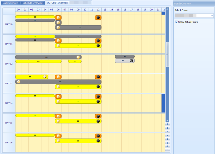

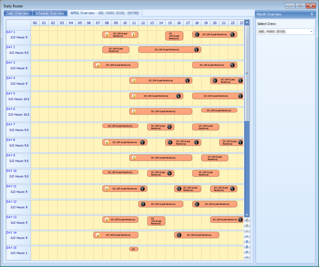

Monthly Overview
The Monthly Overview window provides an overview of the crew monthly schedule.
Figure 4-6 Monthly Overview
From the Roster Daily, Calendar Editor, select the month to view.
In the Daily Overview tab, select a crew and then navigate to the Montyly Overview tab to view the selected crew monthly schedule.
To view another crew for the same month, select the name from the drop-down list. You can only select one crew at any given time.
In the Monthly Overview tab, the same function as the Schedule Overview applies where you are allowed to add, modify, remove or paste a roster schedule.
If the Time Attendance, Use Clock-In/Clock-Out parameter is enabled, the View Clock-In/Out menu button and Show Actual Hours checkbox will be available.
Select the Show Actual Hours checkbox to show the crew actual clock-in/clock-out hours on the grid. The actual hours appear in grey color for each time slot.
Figure 4-7 Monthly Overview Actual Hours View

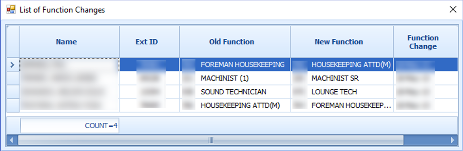

Function Change
The Function Change feature is an information window that lists all the position changes and the dates they were changed. The fields are not editable.
Figure 4-8 List of Function Change

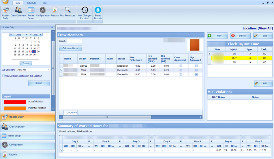

Clock-In/Clock-Out
This feature tracks the Crew Work Hours according to the ILO requirements. The function requires crew members to clock in/out at the start and end of their shift or when they are off for a break.

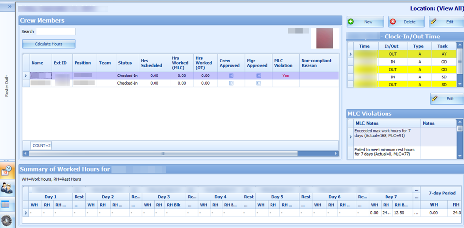

Daily Overview
Figure 4-9 Clock In/Out Daily Overview
Calendar: Dates marked in red denotes dates with roster schedules created
Overview Tab: Lists all crew members that haves schedule on the selected date
Clock-In/Out Time: Clock-In/Out time recorded by the system
ILO Violations: Violations of work hours if any. Refer to the Legend indicators for type of violations
Summary of Worked Hours: A weekly summary of hours worked or rested
Viewing of Crew Schedule
Select the date using the Calendar editor and the Sub-Location from the drop-down list.
Click Search to refresh the window.
In the Crew Member section, a list of crew matching the search criterion appears.
Select a crew name and click Calculate Hours to refresh the information shown.
At the Clock-In/Out Time section, the time logged for each task is shown.
In the Summary Worked Hours section, the past week hours worked/rested is visible.
If the crew work hours violates the ILO Compliance, a note is added to ILO Violations section.
See Table 4-1 description in Time Approval Method section.

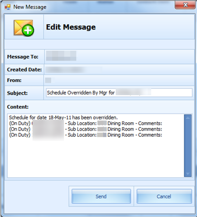

The system generates a notification message informing the crew of the schedule approval/unapproval
If the schedule is approved by the crew and changed by the manager, the crew is notified with a system generated message, indicating the reason for the change
Figure 4-11 Schedule Change Notification
When the manager approves a schedule not yet approved by the crew, the system generates a warning message, notifying the crew of the change.

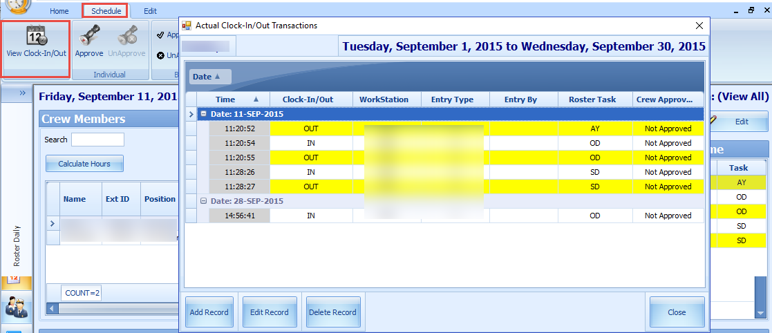

Editing Clock-In/Clock-Out Time
Figure 4-12 Clock-In/Clock-Out Transactions
Go to the Schedule tab and click the View Clock-In/Out button at the ribbon bar.
At the Actual Clock-In/Out Transactions window, select a record to edit.
Click the Edit Record button, alter the necessary details, and click Save.
You can also click Add Record to insert a new clock-in/out record. The "Entered by" column is empty if the record is added/edited by the crew. Otherwise, the column displays the user name.
Click the Delete Record tp prompt a confirmation window. Click Yes to proceed or No to return to the previous window.
To manually add a record, see: Manual Clock-In/Clock-Out.

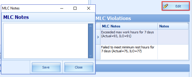

Editing ILO Violations
The edit function in International Labour Organization (ILO) Violations enables the manager to view and input or edit the MLC notes.
To edit, click the Edit button and enter MLC Notes in the MLC Notes window and click Save to update.
Figure 4-13 ILO Violations

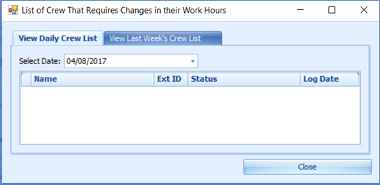

View Changes Required
Figure 4-14 Crew List Requesting Work Hour Change
The View Changes Required function lists all changes requested by crew through the Time and Attendance Terminal, and the function is only accessible by the manager. A change request is generated when the crew presses Changes Required during Clock-In/Out at the Time and Attendance Terminal, Crew members are to discuss the change with their respective manager. It displays the daily/weekly or both daily/weekly request depending on the value defined in the Approved Weekly Hours parameter and/or the Approve Daily Worked Hours Clock-In/Out parameter.
To access this function, click the View Changes Required button on the ribbon bar. The information displayed on this window is a view only. See Editing Clock-In/Clock-Out Time or Manual Clock-In/Clock-Out section on how to change the information.

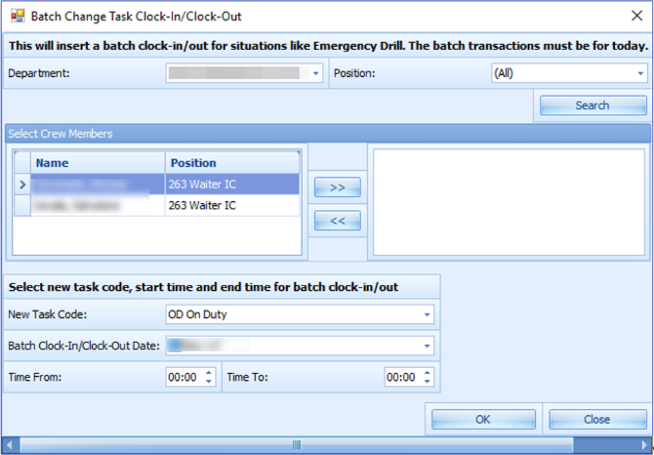

Batch Clock-In/Clock-Out
The Batch Clock-In/Out function allows the manager to perform a batch clock-in/out for the crew on selected tasks such as fire or emergency drill, based on the parameter set in Enable Batch ClockIn/Out. Use of this function is only permissible for users granted with privilege access #4686 - Batch Clock-In/Out. You can only post the batch clock-in/out for tasks past the server time and on the current system date.
At the main window, navigate to the Schedule tab and click the Batch Clock-In/Out button from the ribbon bar.
In the Batch Change Task Clock-In/Out window, select the Department and Position from the drop-down list, and click Search.
Figure 4-15 Batch Clock-In/Out Task
At the Select Crew Members section, a list of crew matching the selection is shown. Select the names and click the double right arrow.
Select the New Task Code, Batch Clock-In/Out Data and Time range from the drop-down list.
Click OK to post the clock-in/out.
For crews whose last transaction was a clock-in, the system performs:
Clock-out with the task code that corresponds with the previous clock-in.
Clock-in with the specified task code.
Clock-out with the specified task code.
Clock-in with the task code that corresponds with (i) and the time is 1 minute after the batch clock out time.
For crews whose last transaction is a clock-out, the system perform
You can manually enter a clock in/out in the In Clock In/Out mode. To access this function, go to the Roster Daily, Crew Members screen, Location (View All) section.
Click New at the Location (View All) section.
At the Add Record window, select the Time, Clock-In/Out and Roster Task from the drop-down list, and click Save. The manually added Clock-In/Out time are classified as “M” type.
The system prompts a warning message when a manual clock-in/out is entered. The warning message defers, depending on the previous activity log. The system does not prevent an entry from being inserted or override the previous entry. It is strongly recommend that you read the warning prompt before clicking the OK button.
