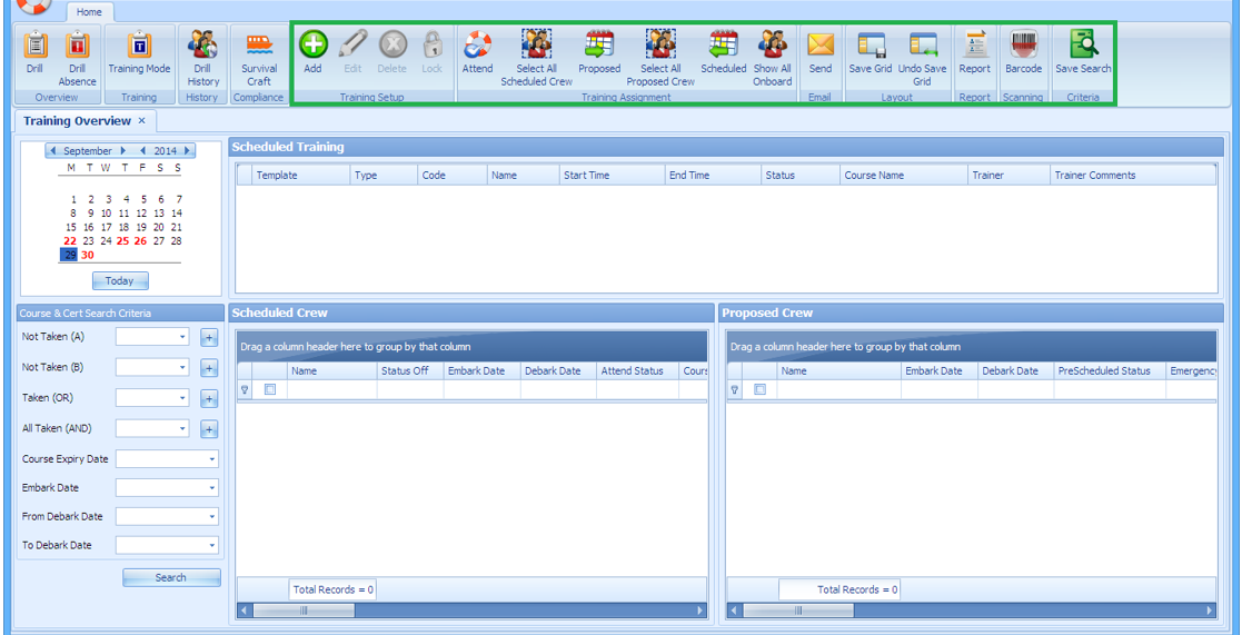

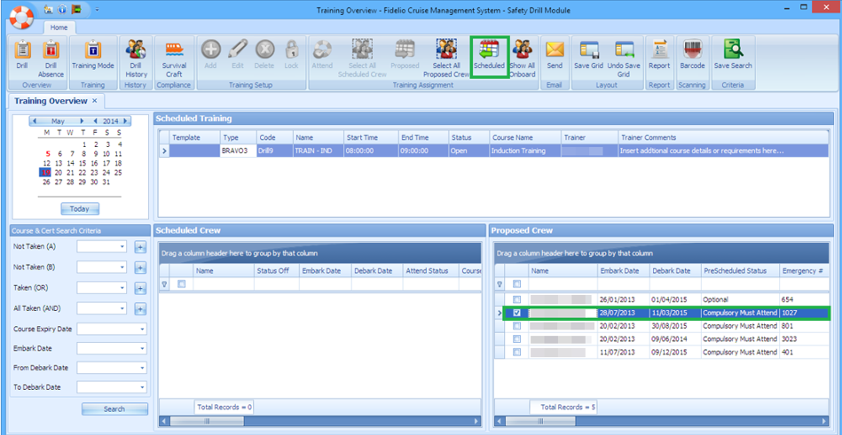

Setting up Training Drill
Similar to the Safety Drill function, you must schedule a drill in the Training Drill mode before assigning a crew to the drill.
At the Training Overview window, select a date from the calendar. Dates that have scheduled drills are shown in red in the calendar.
Click the Add button at the ribbon bar to add a drill.
At the Add Training window, select the Type, Code, Date, Start/End Time, Template, and Trainer from the drop-down list.
Insert the course details/comment, if any.
Click the Save button to save the drill.

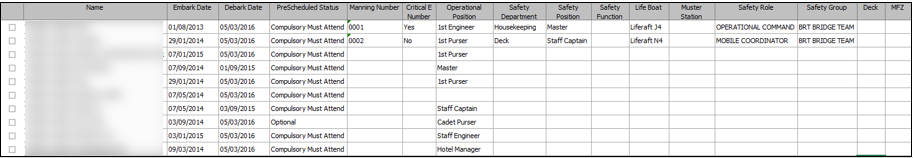

Table 2-2 Field Description of Proposed Crew Grid
| Field Name | Description |
Name |
Crew Name. |
Embark Date |
Crew embarkation date. |
Debark Date |
Crew debarkation date. |
PreScheduled Status |
Defines whether attendance is compulsory or optional. Refers to rules set in Safety Drill Type and Course and Certificate taken |
Emergency # |
Emergency number defined in Muster List Setup |
Critical E Number |
Defines whether the course/certificate will auto expire after Critical E# is changed. Refers to Muster List Assignment. |
Operational Position |
Crew Operational Position. Refers to Crew Operational Position setup. |
Safety Department |
Safety Department assigned. Refers to Safety Department setup. |
Safety Position |
Safety Position assigned. Refers to Safety Position setup. |
Safety Function |
Safety Function assigned. Refers to Safety Function setup. |
LifeBoat |
Lifeboat assigned. Refers to Lifeboat Setup. |
Muster Station |
Muster Station location. Refers to Muster Station setup. |
Safety Role |
Safety role assigned. Refers to Safety Role setup |
Safety Group |
Safety Group assigned. Refers to Safety Group setup |
Deck |
Deck location. Refers to Deck setup. |
Fire zone |
Fire zone assigned. Refers to Firezone setup. |
Stairwell |
Stairwell location. Refers to Stairwell setup. |
Side Location |
Emergency Station location on board the ship. Refers to default system codes. |
Craft Type |
Type of Craft. Refers to default system codes. |
Craft Side |
Safety Boat location - port or starboard. Refers to default system codes. |
Emergency Station |
Station type. Refers to Muster Station Setup. |

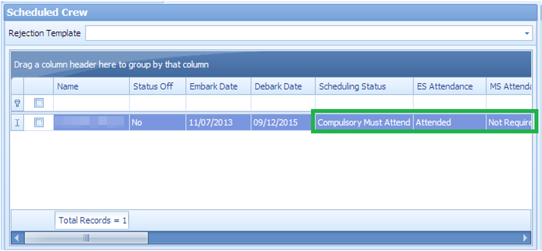

Scheduling Crew to a Drill
From the Calendar tab, select the Drill date, and then select the drill in the Schedule Drill section.
Crew due for drills are listed in the Proposed Crew grid. From the Proposed Crew grid, select by checking the checkbox beside the name or click the Select All Proposed Crew button at the ribbon bar.
Click Scheduled to assign.
At the Scheduled Crew grid, the Status Off field defaults to No. Only crew members with disembarkation after the drill date haves the status set to Yes.
Figure 2-3 Drill Status In Scheduled Crew
Table 2-3 Field Description of Scheduled Crew

Changing Attendance Status
The course attendance is marked by the trainer at the end of the training drill. This process also updates the Course and Certificate as completed in Crew Handling.
Figure 2-4 Course Attendance Function

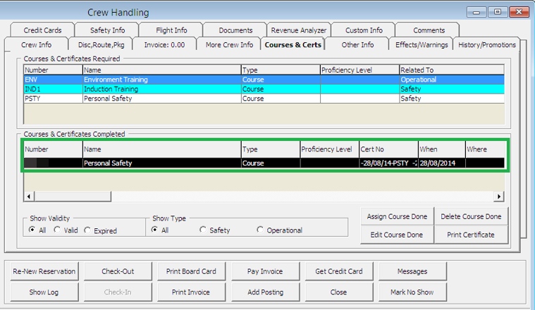

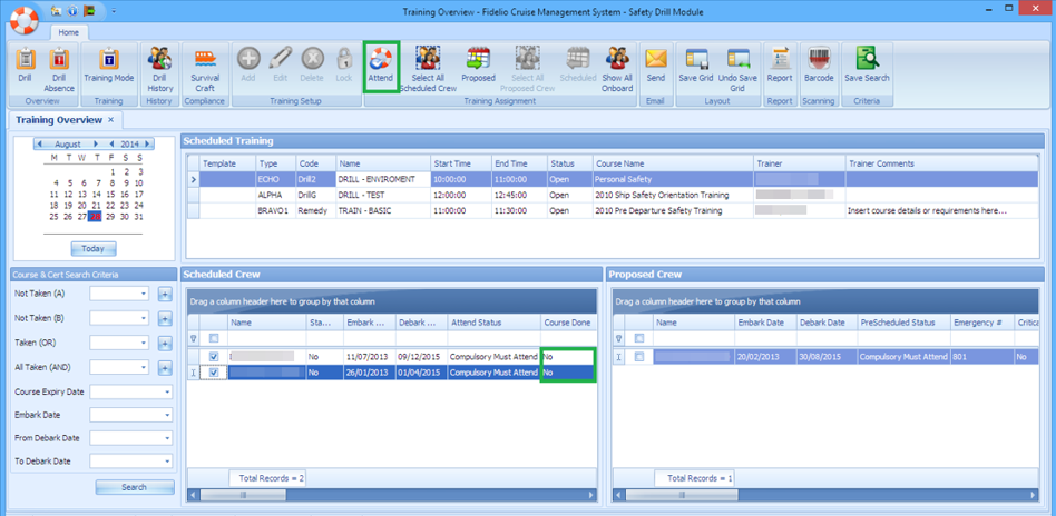

At the selected training drill, select the crew or click the Select All Schedule Crew button.
Click the Attend button to change the attendance status. This changes the Course Done status to Yes, and the Attend button at the ribbon bar switches to Undo Attend. It also sets the Course and Certificate as Completed in the Crew Handling window.
Figure 2-5 Course Attendance in Crew Handling
The system prohibit you from moving the crew from the Scheduled to Proposed window once the attendance in Course Done is set to Yes. You must first reset the status to No.
To reset the attendance, select the name and click the Undo Attend button.

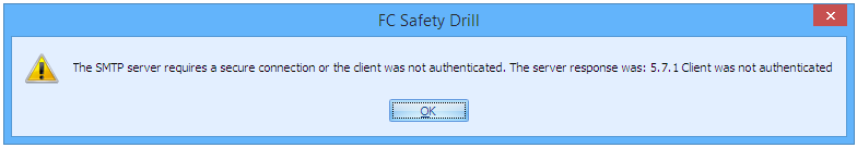

If you receive the prompt, in Figure 2–6 below, this means the SMTP is not set up correctly. Click OK to continue.
Figure 2-6 Invalid SMTP Notification

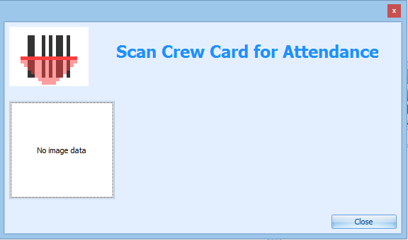

Marking Attendance Using Barcode Scanning
You can mark the course attendance using a barcode scanner (referenced to ‘RES_BOARDCC_EXT’), hardware set up is required in Crew, Options, Hardware. Contact Oracle Hospitality Cruise for hardware requirements and setup.
Figure 2-7 Crew Attendance by Barcode

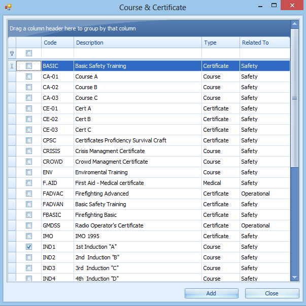

The search function allows you to search for courses set up based on the selected drill type. You can save the searched information into a template for future use.
Searching for Crew by Course
Select one of the following options from the drop-down list on the left of the Training Overview window. The search results are based on the selected filter.
Not Taken (A)
Not Taken (B)
Taken (OR)
All Taken (AND)
To select more than one course type, click the plus sign (+) to open a detailed Course & Certificate window, select the Courses and then click Add.
Figure 2-11 Course and Certificate Selection in Search Filter
At the Course & Certificate Search Criteria window, enter the applicable filter and click Search.
To save the search filter as a template, click Save Search on the button at the ribbon bar.
