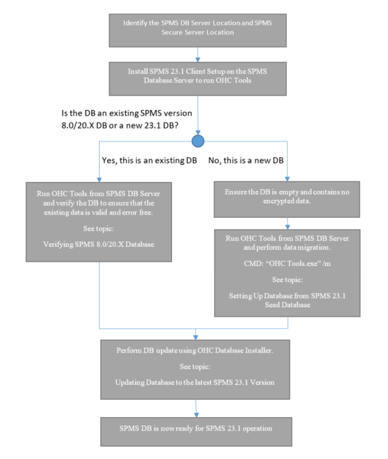

The diagram below summarizes the process of setting up the SPMS Database Server based on the options available to you when preparing the SPMS 23.1 Database.
Figure 4-1 Database Preparation Workflow

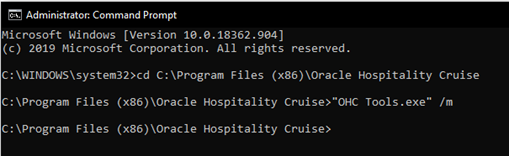

Run the Windows Command Prompt as a Windows Administrator.
Navigate to the Installed SPMS Application folder. For example,
C:\Program Files (x86)\Oracle Hospitality Cruise. -
Run the OHC Tools for Database migration using the following command.
“OHC Tools.exe” /m.Figure 4-5 Windows Command to Launch OHC Tools

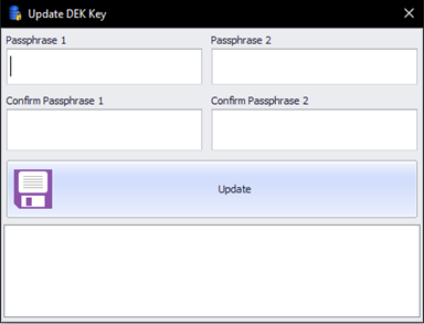

Click the Upgrade DPAPI Key button to create a new Database entry record to both the local OHCSecurity.par file and at the SPMS Secure Server.
At the Security Login prompt, select the Database TNS and enter the Database Password for authorization.
Key in the passphrase and click the Update button.
Figure 4-7 Encryption Passphrase Update Form
Upon completion, you will find that the SPMS Database password and encryption key are safely encrypted and stored by the SPMS Secure Server.

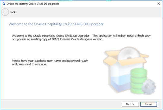

Run the Windows Explorer program and navigate to the Oracle Hospitality Cruise folder.
Double-click the OHC Database Installer.exe to launch the program.
Figure 4-8 OHC Database Installer Welcome Screen
Click the Next button to navigate to the next screen.

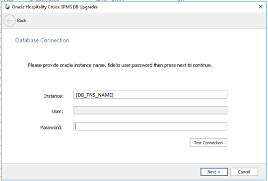

Figure 4-9 OHC Database Connection Instance Selection/Password.
On the Database Connection screen, enter the Database TNS name and Database Schema Password for SPMS.
If the Database TNS name or Database Schema password is incorrect, you will receive an error message. Correct the information and retry.
To validate the Database connection, click the Test Connection button.
Figure 4-10 OHC Installer DB Connection Successful

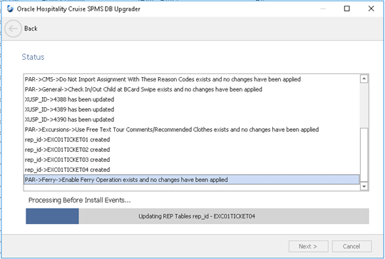

On the Confirm screen, click the Next button to start the SPMS Database Version update process. If there are SPMS applications connected to the SPMS Database, you will receive a message to remind you to close all applications or terminate the SPMS Database connection with the application. Close all applications and click Yes to continue.
Figure 4-11 Update Progress of OHC Database Installer
The SPMS Database Version Update progress is shown in the Status screen. When the update process completes, click the Next button to proceed.
