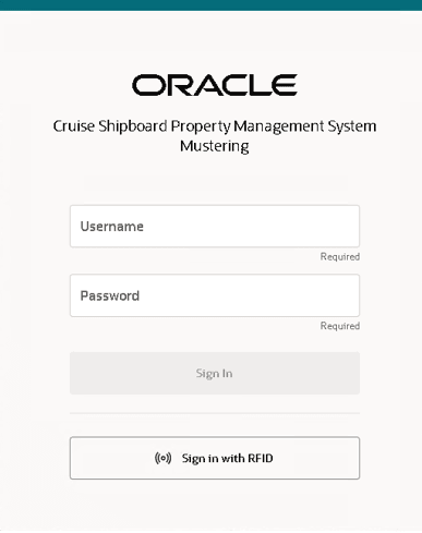

Figure 1-1 Login Page
This figure shows the Login Page

Log in to the Application (Credential Login)
  1. On the application page, enter your user name and password.
    The user name and password is case-sensitive
  2. If you sign in with an incorrect user name, password or both, you will receive an error ‘Invalid login, Please try again’, and the field color changes to red before locking the account.
    The number of failed attempts and lock duration is managed by the value set in Max Login and Lockout Minutes parameter.
  3. Upon successful login, the user name and profile picture is shown at the top right of the page, and navigates to the Register page.
  4. To log out from the application, select the arrow down icon on the page and then the Sign Out button when shown, before navigating to the login page.
  5. For user account that does not have permission to the application, a Permission is required to view this application shall prompt.
  6. When a full data download from the server to the device is in progress, you may experience slowness during registering/unregistering a profile in an Online mode.
