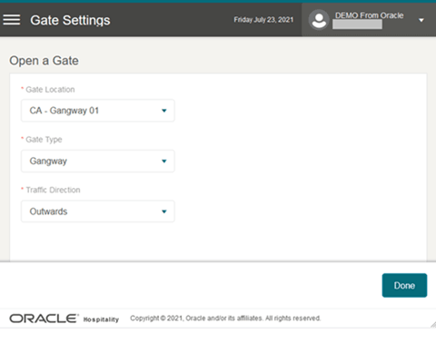

Gate Settings
Figure 15-1 Gangway Settings
This figure shows the Gangway Settings

  1. From the Gateway Security, Gateway Movement menu, select Gangway / Tender sub-menu.
  2. On the Gate Settings page, select a value for all the mandatory fields:
    • Gate Location – the value is obtained from the Administration menu under Gate Location
    • Gate Type
    • Traffic Direction

      You can only select Outwards or Inwards from the Traffic Direction
  4. Select the Done button. The system navigates to the People Movement page where the gate settings appear at the top of the page. See Tender Boat topic for Gate Settings on Tender Boat.
    Once a gate setting is selected, you cannot change the Gate Settings, Gate Type from the People Movement page. The change can only be done from the Gate Settings page. However, you can change the traffic direction.
    Before you start the People Movement process, make sure the Gate Location name does not exceed more than 50 characters.
