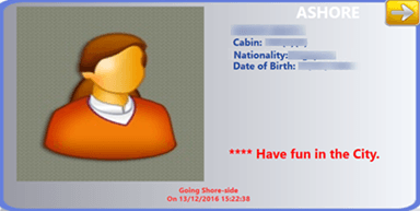

Figure 19-5 Account Information Tile
This figure shows the Account Information tile.

When disembarking crew swipe their board card through the MSR. The system prompts an Ashore Denied Override dialog box with the following message: ‘The person is ashore denied; do you want to override the onboard status?’. Click Yes to change the account status to Ashore and display a “Crew Disembark Today” statement on the Ashore Status Information board.
