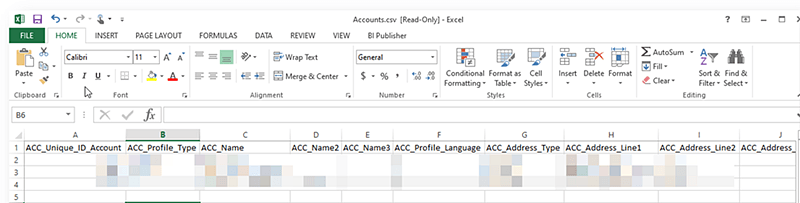

Table 26-8 Sales Account Profiles (Company/Agent/Source)
Column Name Description Max Data Length Sample Data Mandatory
ACC_Unique_ID_Account (PK)
Unique ID value for Sales Account in the uploaded csv files for data type Accounts within an import cycle.
Ex: (40001, AC40001)
supported icon
ACC_Profile_Type
The type of sales account. The account type can be TA, Source, and Company.
Ex: (TA, SOURCE, COMPANY)
Enter the profile type in uppercase.
supported icon

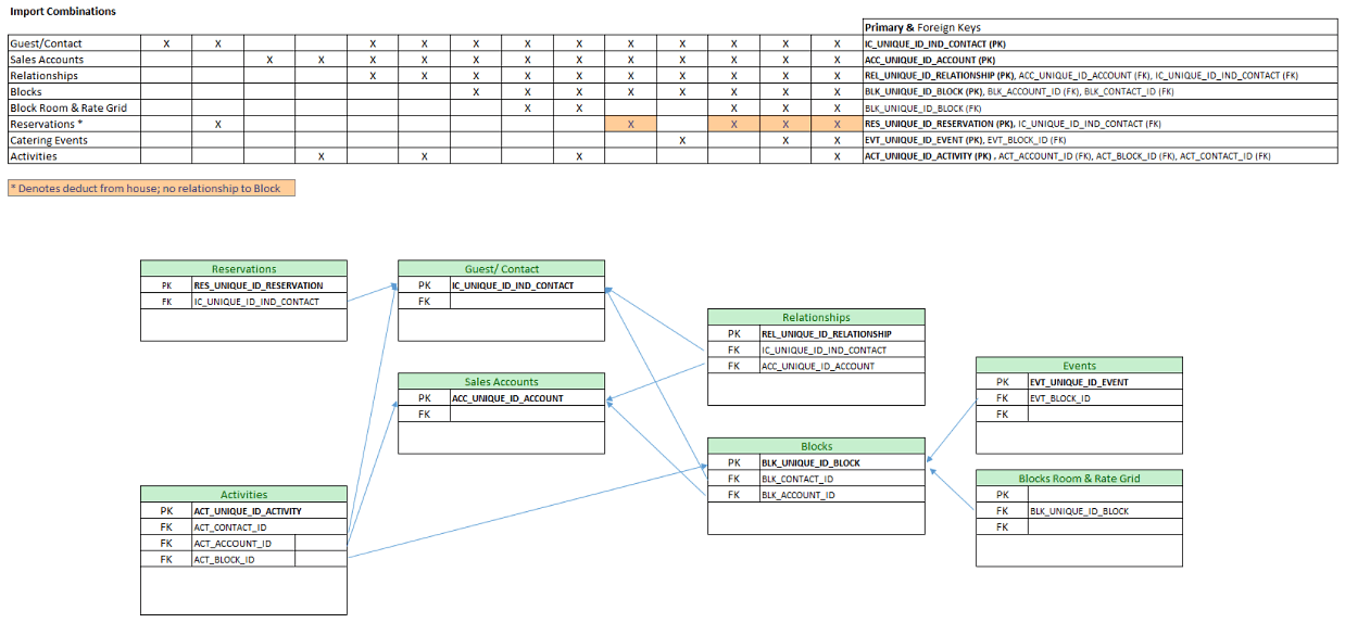

Data Type / Entity Relationships
This image displays the Data Type/ Entity Relationship diagram.
To establish the relationship between records in each data type, the Unique ID primary key (PK) values are referenced as the foreign key (FK) IDs in other entities.

Importing Profiles and Relationships
Guest and Contact Profiles
To import guest profiles, set the IC_Contact_YN field to N. To import guest as contact profiles, set the IC_Contact_YN field to Y. The KeepHistoryYN and ActiveYN check box fields for Individual/Contact profiles are defaulted to Y for all the imported profiles.
Table 26-14 Guest (Individual) / Contact Profiles
Column Description Max Data Length Sample Data Mandatory
IC_Unique_ID_Ind_Contact (PK)
Unique ID value for Guest/Contact Profiles in the uploaded csv files for data type Guest/Contact Profiles within an import cycle.
  • Primary Key
200
Ex: (30001, INC20001)
The ActiveYN field for Sales Accounts defaults to Y for all imported profiles.
Table 26-15 Sales Account Profiles (Company/Agent/Source)
supported icon
ACC_Profile_Type
Ex: ( TA, Source, Company)
supported icon
ACC_Name
Name of the account profile.
80
Ex: ( Company Name, Source Name)
supported icon
ACC_Name2
Second name of the account profile.
80
ACC_Name3
Third name of the account profile.
80
ACC_Profile_Language
Primary language of the profile; pre-configured in OPERA Cloud.
20
Ex: (DE, E, RU)
ACC_Address_Type
The address type code; pre-configured in OPERA Cloud.
80
Ex: (HOME, BUSINESS)
ACC_Address_Type1
The first line of street address.
80
Ex: 100 West Monroe
ACC_Address_Type2
The second line of street address.
Ex: Suite 100
ACC_Address_Type3
The third line of street address.
ACC_Address_Type4
The fourth line of street address.
ACC_City
The City of this address.
Ex: (Chicago)
ACC_Postal_Code
The Postal Code of the address.
Ex: (60601)
ACC_Postal_Code_Ext
The Postal Code Extension of the address.
Ex: (0401)
ACC_Country
The Country code of the address; pre-configured in OPERA Cloud.
Ex: (US)
ACC_State
The State code of the address; pre-configured in OPERA Cloud.
Ex: (IL)
ACC_Address_Language
The Language code used for the address; pre-configured in OPERA Cloud.
Ex: (E, JPN, CHN)
ACC_Ref_Currency
Currency code to be used for the commission payment; pre-configured in OPERA Cloud.
Ex: (INR, USD)
ACC_Communication_Type1
The Communication type code; pre-configured in OPERA Cloud.
4000
Ex:  (MOBILE)
ACC_Communication1
The value for the communication for ACC_Communication_Type1.
4000
Ex: 9999999111
ACC_Communication_Type2
4000
Ex:  (WEB)
ACC_Communication2
The value for the communication for ACC_Communication_Type2.
4000
ACC_Communication_Type3
4000
Ex:  (EMAIL)
ACC_Communication3
The value for the communication for ACC_Communication_Type3.
4000
Ex: (xxxx@xxxxx.xxxCode:
EMAIL

Relationships (Account/Contact)
  • Records reference the ACC_Unique_ID_Account and IC_Unique_ID_Ind_Contact values from Sales Account and Guest/Contact data files respectively.
  • The default relationship between the account and Guest/Contact profile will be Employer (Type: ACCOUNT) and Employee (Type: CONTACT) relationship.
Table 26-16 Relationships (Account/Contact)
REL_Unique_ID_Relationship  (PK)
Unique ID value for Relationship in the uploaded csv files for Data type Relationships within an Import cycle.
200
Ex: (50001, RL50001)
supported icon
ACC_Unique_ID_Account (FK)
Foreign Key: Linked Unique ID value of Sales Account Profile. Reference PK value from Sales Account data file within an import cycle.
200
Ex: (40004, AC40004)
supported icon
IC_Unique_ID_Ind_Contact (FK)
Foreign Key: Linked Unique ID value of Guest/Contact Profile. Reference the PK value from Guest/Contact data file within an import cycle.
200
Ex: (30003, INC20003)
supported icon
Importing Reservations
  • Records reference the IC_Unique_ID_Ind_Contact from the Guest/Contact data file.
  • Reservation Status is auto-populated with values: Reserved (if arrival date is greater than business date), Arrival (if arrival date is equal to business date).
  • Valid credit card payment methods can be specified (credit card numbers are not supported), check payment method and cash payment method. Direct Bill payment type is not supported. When the Mandatory Method of Payment OPERA Control is active, validation will occur and an error presented if the Payment Method is not defined for a reservation.
  • All reservations are imported irrespective of the room type or house availability or rate restrictions.
Table 26-17 Reservations
