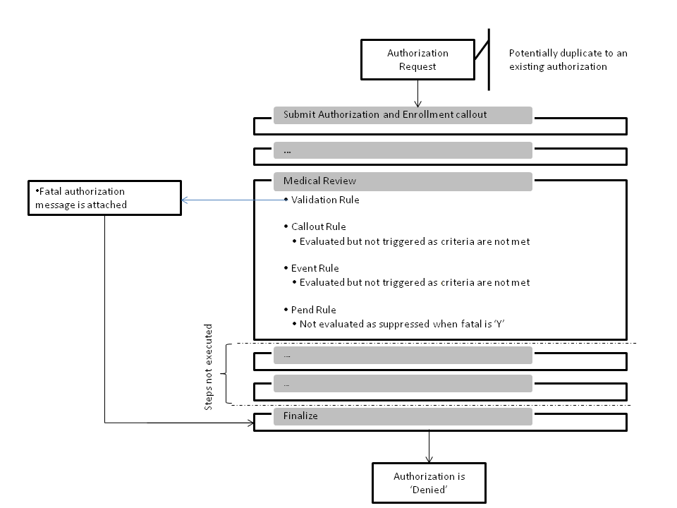

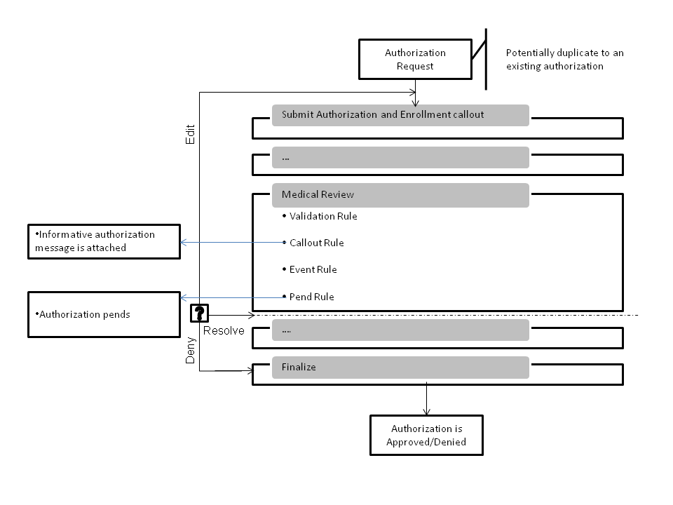

The images below show the following situations:
When the Combination Check fails and a fatal message is attached
When the Combination Check passes, but the documents are missing
Image #1:
Image #2
