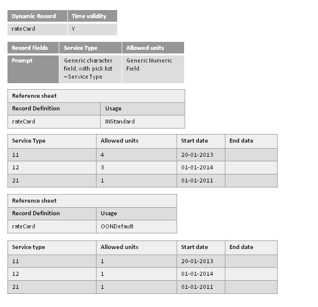

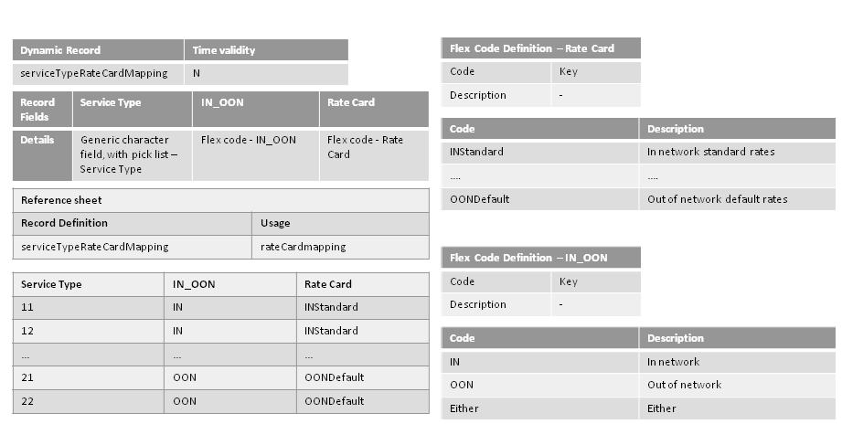

The function dynamic logic requires two reference sheets to be set up. The first reference sheet holds the mapping between the service types and rate cards. = The second reference sheet is the rate card. For details on the set up of the reference sheets; refer to section "Reference Sheets" in the Dynamic Logic chapter of the Developer Guide.
Reference Sheet #1
Reference Sheet #2
The function dynamic logic looks up the reference sheet 'serviceTypeRateCardMapping' based on the service type code and service provider group scope. It then selects the applicable rate card reference sheet. So, if the service type code on the authorization is 11 and service provider group scope is IN then 'INStandard' rates will be applied and the reference sheet 'INStandard' will be selected. The allowed number of units will be looked up in 'INStandard' for service type 11. If the number of allowed units is greater than the value of requested number of units on the authorization, then the authorized number of units is set to the requested number of units; otherwise, the authorized number of units is set to the allowed number of units.
