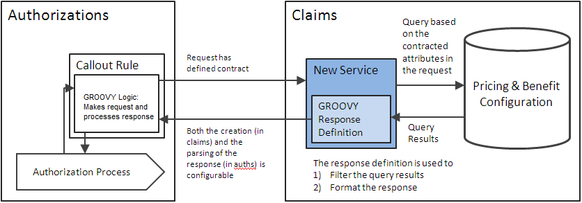

Claims Advice Service is a REST based API exposed by OHI Claims Adjudication to check if a specific medical service is contracted and/or covered based on the configuration in OHI Claims, without processing an actual claim.
The path where this service be available will be:
http://<HOST_ADDRESS>:<HOST:PORT>/<CONTEXT_ROOT>/claimsadviceservice
The service will expose a POST method. "adviceResponseDefinitionCode" can be passed in as a Accept Header parameter to specify which dynamic logic on the claims side should be picked up to create the response. If there is no header parameter passed in, a default definition is picked up. In case no defaults are defined, an error message is given back with status code 406 (Not Acceptable).
The following fields are configured to set up an advice response definition:
| Field | Description |
Code |
Uniquely identifies the advice response definition |
Description |
The description of the advice response definition |
Response Mapping |
The dynamic logic that is executed to generate the response message for the external system |
Default? |
Indicates that this is the default advice response definition (only one advice response definition can be marked as default) |

Response Structure
The return type of the service will be a structure returned by the dynamic logic. It can be a XML/JSON or a plain string depending upon the dynamic logic construction.
