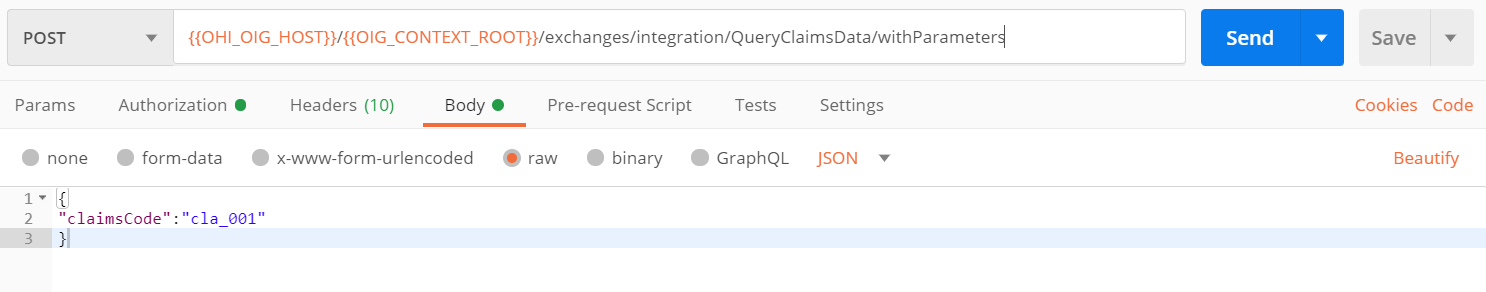

This integration when triggered would query claims data by sending in the following GET request to OHI Claims Adjudication and Pricing
http(s)://{host:port}/{context root}/generic/claims?q=code.eq ({this will be the claimsCode value supplied during intergation invocation)
The accept header for this GET request gets set to application/json;expand=addressList|maritalStatusList
The response received from the OHI Claims Adjudication and Pricing is available as the "raw payload" to the delivery step. If transformation logic is not configured then this reasons in its as-is form is delivered to the configured delivery destination.
In this example, dynamic logic transformClaim is configured to read the OHI Claims Adjudication response and convert it into the format expected by the external system. The response from OHI Claims Adjudication and Pricing application is accessible in the dynamic logic transformClaim through bind variable claimsResponse. For more details on transformation possibilities and How tos refer to chapter Transformation Dynamic Logic in the guide.
This integration can be invoked using Exchange Integration Point - with parameters options (see image), with claimCode being the request parameter.

This integration can be invoked using Exchange Integration Point - With Payload.
In this example the exchange invocation payload is the same as the payload required by the long-running operation. Alternatively, the dynamic logic function 'Invoke Function Payload' can also be implemented to generate payload.
   "limitCodes" : [ "code1", "code2", "..."],
   "transactionStartDateTime" : {
      "value" : "..."
   "transactionEndDateTime" : {
      "value" : "..."
