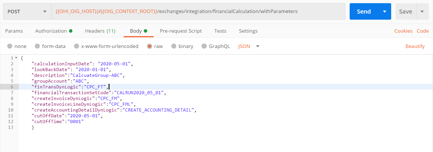

Note that in this configuration all the activity parameters are parameterized. This means they must be supplied at the time of integration invocation. Optionally If there are/is step(s) before calculating premium then these parameters can be added as exchange properties in the preceding dynamic logic. For more details on the parameterization of the configuration refer to the section Integration Parameters and Exchange Properties of the chapter Integration in this guide.
Also, note that activity invocation in Policies applications is an asynchronous processes, and therefor indicatorExpectNotification is set to true for all the ACTIVITY steps. Oracle Insurance Gateway expects notification from the interfacing OHI application to resume an integration invocation that is currently in waiting status.

The image below shows the invocation of this integration using Exchange Integration Point - With Parameters
