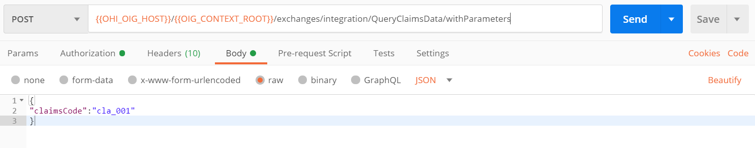

This integration can be invoked using Exchange Integration Point - with parameters options (see image), with claimCode being the request parameter.

Extract Invocation
This integration can be invoked using Exchange Integration Point - With Parameters.
