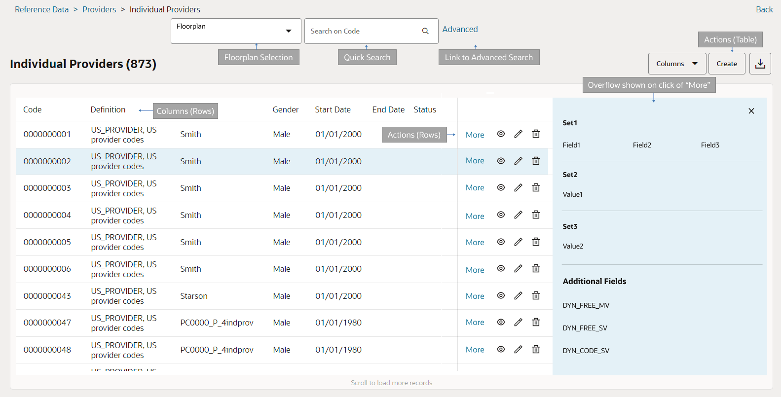

Search Object Table View Page Layout

Entity Name and Results Count
  • Non-configurable, default functionality
  • The entity name plural is displayed above the table. The total count is displayed next to it
  • The count is displayed only when the user has performed a search
  • If no results match the search criteria, the results component displays the message 'no rows were found'.
Floor Plan Selection
  • Search Object - Table View template supports multiple floor plans for the same page
  • The user can switch context with a drop-down button located next to the quick search input
Actions
  • Optional component
  • By default no action is available unless specified in the floor plan
  • Only 'Add' available at page level, action link 'Create' is displayed when defined
  • Re-directs user to the create object page (recursive) in create object mode
  • When more than one view and edit object plans are evaluated by the system, then they are all displayed as available options in the drop-down. A user selects one of the options and the create object page is displayed using the selected floor plan
  • If only one plan is evaluated, then the drop-down is not displayed and on selecting the action 'Create', system immediately opens the create object page using the evaluated template
  • For details on floor plan evaluation refer to the chapter "Presentation Configuration" in the Developer Guide.
  • Create as drop-down list - The floor plan description is displayed. The options are ordered based on the floor plan code ascending. Selecting a plan from the list, opens the create object page for the resource using the selected template

Auto Fetch
  • Optional property
  • Set true to auto fetch records
Pre-filter
  • The setting 'preFilter' takes in criteria that is executed for all the searches as 'and' condition
  • This limits the result set on which the search is performed
  • The filter conditions can be set using HTTP Query API grammar; for example, setting preFilter to
    integration.code.eq "PROVIDER_EXTRACT"
    for exchanges search page, will show exchanges having integration code equal to 'PROVIDER_EXTRACT'
  • Example use case: To limit the results based on the value of a field within the resource in case if multiple search table floor plans are defined
  • Center aligned
  • Can be customized to search on multiple attributes including flex codes, reference fields
  • For more details refer Quick Search component
  • Displayed as a hyperlink which displays the advanced search dialog
  • Enables search on a combination of attributes
  • For more details refer Advanced Search component
Sort
  • Displayed next to Actions when defined
  • Can have only the default or multiple sort criteria
  • For more details refer Sort Component component page
Filter
  • Filter criteria is defined to give users option to further filter the search results
  • A filter entry is used to restrict the search query, not to compose a new query
  • Example use case: Filter defined on a resource which can have multiple statues like completed, in-progress, started etc.
  • For more details refer Filter component page
Table
  • Required component
  • Used to display the search results in form of a table
Table component consists of the following sub-components:
Rows
  • All table properties are defined under rows and rows are configured with the following components:
Actions
  • View, Edit, Copy, and Remove are displayed for each row when configured.
  • Action Remove, deletes the object from the list.
  • A dialog seeking user confirmation Delete this record? with Ok and Cancel is displayed when this action is selected. Selecting Ok deletes the record.
  • When the record deletion is successful, a success confirmation message {object name singular} deleted is displayed as specified in the section Indicating Success of the Response Messages chapter in the Developer Guide.
  • If any messages are returned from the server other than success, then they are displayed on the UI.
  • Action View opens the View and Edit object page in the view mode.
  • Action Edit opens object page edit mode.
    • To edit a row inline, configure inlineEdit at the floorplan level. Once configured, the system displays an additional Edit action to edit the row inline.
      inlineEdit configuration applies only to the episodes page.
  • Action Copy opens the View and Edit object page in edit mode by cloning the object selected for copy.
  • The menu (…​) displays additional actions when more than three actions are configured for a row.
Columns
  • Each property defined in this section forms a column in the table
Labels
  • It is used to display property values in form of a label and can take in exactly one property per label
  • Multiple labels can be added to the results
Region
  • Used if additional properties need to be displayed for the row overflow region
  • The region will slide in from right hand side of table on clicking "More" link, with X (close icon) to close
  • Set 1 and Set 2: Sets are used to display multiple properties as a set. Each result can have up to 2 sets.
  • It is recommended to use only Set 1 when using the filter component on the page.
For more details refer Table component page
