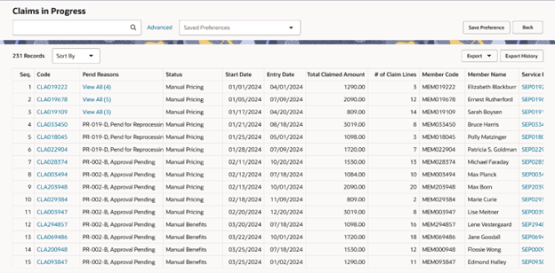

The following image illustrates how the Advanced Search can be configured.
Advanced Search with Operators
Example
"advancedSearch": {
    "properties": [
            "name": "agent_code",
            "sequence": 3,
            "refType": {
                "type": "agents"
"refTypeMapping": [
        "type": "agents",
        "properties": [
                "name": "code",
                "viewColName": "agent_code"
                "name": "name",
                "viewColName": "agent_name"
