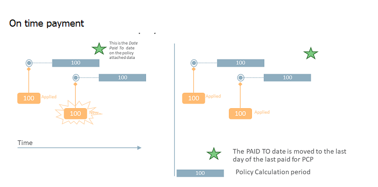

Scenario A: On Time and Exact Payment
In this scenario the registration of amount 100 is received on the pay date of the calculation period. The amount expected for the period is also 100. Therefore, payment is on time and is exact. The 'Date Paid To' is updated to the period end date and the registration is considered as 'Applied'.
