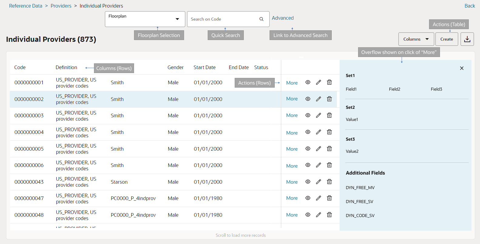

Components
Pages using Search Object - Table View template has the following components:
Entity Name and Results Count
Non-configurable, default functionality
The entity name plural is displayed above the table. The total count is displayed next to it
The count is displayed only when the user has performed a search
If no results match the search criteria, the results component displays the message 'no rows were found'.
Floor Plan Selection
Search Object - Table View template supports multiple floor plans for the same page
The user can switch context with a drop-down button located next to the quick search input
Actions
Optional component
By default no action is available unless specified in the floor plan
Only 'Add' available at page level, action link 'Create' is displayed when defined
Re-directs user to the create object page (recursive) in create object mode
When more than one view and edit object plans are evaluated by the system, then they are all displayed as available options in the drop-down. A user selects one of the options and the create object page is displayed using the selected floor plan
If only one plan is evaluated, then the drop-down is not displayed and on selecting the action 'Create', system immediately opens the create object page using the evaluated template
For details on floor plan evaluation refer to the chapter "Presentation Configuration" in the Developer Guide.
Create as drop-down list - The floor plan description is displayed. The options are ordered based on the floor plan code ascending. Selecting a plan from the list, opens the create object page for the resource using the selected template
Example use case: To make a search table page view only, no actions are defined at page and results level
External Links
Optional Component
Links are placed next to create object action for pages where widgets are not supported.
Links are placed in card (tile), on the pages that support widgets.
For more details refer Links component
Pre-filter
Optional component
The setting 'preFilter' takes in criteria that is executed for all the searches as 'and' condition
This limits the result set on which the search is performed
The filter conditions can be set using HTTP Query API grammar; for example, setting preFilter to
integration.code.eq "PROVIDER_EXTRACT"
for exchanges search page, will show exchanges having integration code equal to 'PROVIDER_EXTRACT'
Example use case: To limit the results based on the value of a field within the resource in case if multiple search table floor plans are defined
Quick Search
Optional component
Center aligned
Can be customized to search on multiple attributes including flex codes, reference fields
For more details refer Quick Search component
Advanced Search
Optional component
Displayed as a hyperlink which displays the advanced search dialog
Enables search on a combination of attributes
For more details refer Advanced Search component
Sort
Optional component
Displayed next to Actions when defined
Can have only the default or multiple sort criteria
For more details refer Sort Component component page
Filter
Optional component
Filter criteria is defined to give users option to further filter the search results
A filter entry is used to restrict the search query, not to compose a new query
Example use case: Filter defined on a resource which can have multiple statues like completed, in-progress, started etc.
For more details refer Filter component page
Table
Required component
Used to display the search results in form of a table
Table component consists of the following sub-components:
Rows
All table properties are defined under rows and rows are configured with the following components:
Actions
'View', 'Edit', 'Copy' and 'Remove' are displayed for each row when configured
Action 'Remove', deletes the object from the list.
A dialog seeking user confirmation 'Delete this record?' with 'Ok' and 'Cancel' is displayed when this action is selected. Selecting 'Ok' deletes the record.
When deletion of the record is successful, a success confirmation message '{object name singular} deleted ' is displayed as specified in the section "Indicating Success" of the Response Messages chapter in the Developer Guide.
If any messages are returned from the server other than success; then they are displayed on the UI
Action 'View' opens the 'View and Edit' object page in the view mode and the action 'Edit' opens it in the edit mode. Action 'Copy' opens the 'View and Edit' object page in the edit mode by cloning the object selected for copy.
3 Dots menu is shown with additional actions, when more than 3 actions are configured for a row
Labels
It is used to display property values in form of a label and can take in exactly one property per label
Multiple labels can be added to the results
Region
Used if additional properties need to be displayed for the row overflow region
The region will slide in from right hand side of table on clicking "More" link, with X (close icon) to close
Set 1 and Set 2: Sets are used to display multiple properties as a set. Each result can have up to 2 sets.
It is recommended to use only Set 1 when using the filter component on the page.
For more details refer Table component page
