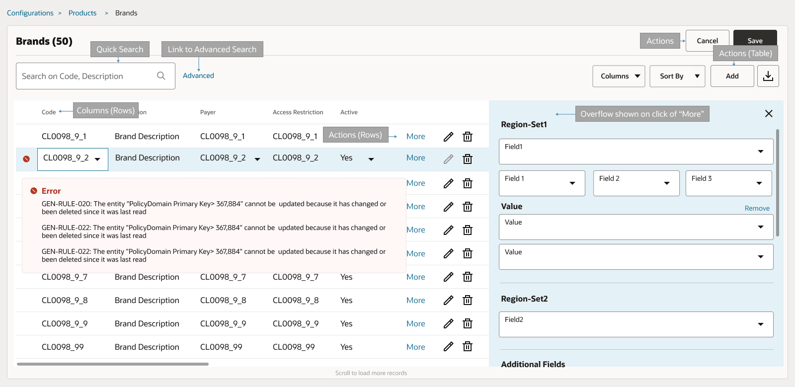

Components
Pages using View and Edit Object - List template has the following components:
Entity Name and Results Count
Non-configurable, default functionality
The entity name plural is displayed above the table. The total count is displayed next to it
The count is only displayed when the user has performed a search
If no results match the search criteria, the message indicating that no rows were found is displayed by the results component
Primary Navigation Actions
The primary navigation actions 'Cancel' and 'Save' are available on the page in the edit mode
Action 'Save' saves the object list and brings the object list back to view mode.
During save operation, the page gets into the Busy State-'Cancel Not Allowed.
When the request is processed and a response has been received, the page leaves the busy state, and the object is displayed again in the view mode in case of success or in the edit mode in case of failure.
Either a success confirmation or object validation messages are displayed. Server side validation errors are displayed in the overflow area of the erroneous record and a generic message about the presence of errors is displayed above the table component.
If the user decides to 'Cancel' editing the object list, a confirmation message is displayed in case there are outstanding edits on the page.
Optimistic locking is applicable when an object list is saved.
Configurable Actions in Floor Plan
Optional component
By default no action is available unless specified in the floor plan
Only 'edit' can be configured at page level, action link 'Edit' is displayed when defined
The primary navigation action 'Edit' is available on the page in the view mode only (when configured)
Action 'Edit' brings the object list in the edit mode and the object list can now be updated.
When action 'edit' is not defined then the page gets rendered as view only.
This also implies that the object cannot be brought into edit state. Action 'edit' should be configured on the plan to get the object in edit mode.
Example use case: To make a page view only, no actions are defined at page and table level
External Links
Optional Component
Links are placed next to the Edit action
For more details refer Links component
Quick Search
Optional component
Center aligned
Can be customized to search on multiple attributes including flex codes, reference fields
For more details refer Quick Search component.
Advanced Search
Optional component
Displayed as a hyperlink which will display the advanced search dialog
Enables search on a combination of attributes
For more details refer Advanced Search search component
Sort
Optional component
Displayed next to Advanced search when defined
Can have only the default or multiple sort criteria
For more details refer Sort Component component page
Pre-filter
Optional component
The setting 'preFilter' takes in criteria that is executed for all the searches as 'and' condition
This limits the result set on which the search is performed
The filter conditions can be set using HTTP Query API grammar; for example, setting preFilter to
integration.code.eq "PROVIDER_EXTRACT"for exchanges search page, will show exchanges having integration code equal to 'PROVIDER_EXTRACT' -
Example use case: To limit the results based on the value of a field within the resource in case if multiple search table floor plans are defined
Pagination
Optional component
Infinite scroll to load next page of records when scroll ends
Pagination component can be configured to display the page size of the table
Table
Required component
Used to display the search results in form of a table
If no results match the search criteria, the results component displays the message 'no rows were found'.
Table component consists of the following sub-components:
Actions (Table Level)
The Add button is displayed at the table level when configured.
The Add action adds a new record to the object list; that is, a new row is added to the top, with check (Apply) and cross (Cancel) icons.
The check adds a new row to the table, and the Save button saves the row data with any changes made to the table.
The Columns dropdown is displayed when flexcolumn setting is set to
true. -
The Columns dropdown is displayed at the table level when more than seven columns are configured on the desktop.
Used to display columns in a table by selecting or unselecting options from the Columns dropdown.
Rows
Rows can be configured with the following components:
Actions
'Copy', 'Remove' is displayed for each record when configured in the row component
Action 'Remove', deletes the object from the list
Action 'Copy' clones the selected object and creates a new entry in edit mode.
Columns
Each property defined in this section forms a column in the table.
Labels
It is used to display property values in form of a label and can take in exactly one property per label
Multiple labels can be added to the results
Region
Used if additional properties need to be displayed for the row overflow region
The region will slide in from right hand side of table on clicking "More" link, with X (close icon) to close
Set 1 and Set 2: Sets are used to display multiple properties as a set. Each result can have up to 2 sets.
It is recommended to use only Set 1 when using the filter component on the page.
For more details refer Table component page
Conditions
Optional component
Can be used to control conditional display of fields
For more details refer to Condition component page
