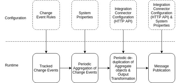

The Integration Connector builds on an Oracle Health Insurance application’s capability to configure business rules for detecting changes and the ability to inform external systems of these. It allows processing of Change Events of type 'Message' into messages that an external system can consume. The Integration Connector’s high-level workflow is outlined in the following diagram:
Integration Connector Configuration and Runtime
Change Event Rules
The Security Guide of an Oracle Health Insurance application that features the Integration Connector provides details on configuration of Change Event Rules of type 'Message'. The same documentation lists the Event Levels, like Person or Organization, and how Change Events of a certain level are aggregated into Aggregate Event types.
Aggregate Events
The system translates detailed Change Events into Aggregate Events. An example is a change that is detected at the level of an Organization Address; the system translates that in an Aggregate Event at the Organization level.
Aggregate objects define the level at which messages are constructed using Dynamic Logic: aggregate objects are passed in as bind variables. The Developer Guide defines the signature for Message Transformation Dynamic Logic functions.
The system periodically aggregates Change Events into Aggregate Events. The period is configurable through system property "ohi.connector.event.aggregation.interval". By default it is 300 seconds. By decreasing the aggregation interval external systems can be informed of changes faster.
Decreasing the value results in more frequent processing of a task. For example, a value of five seconds results in approximately processing 20 tasks per minute. Chances are that an application may overload. To avoid application overloading, a value greater than 100 is recommended.
If multiple details for an aggregate object are changed over time, decreasing the aggregation interval may result in the external system having to handle a larger amount of messages for the same aggregate object.
