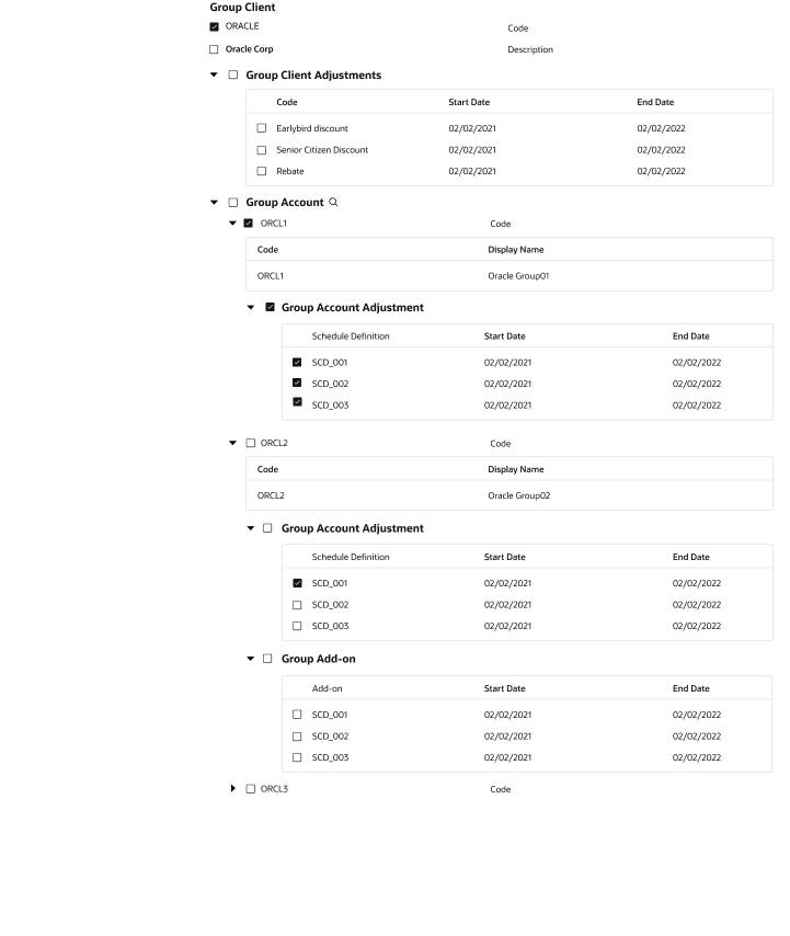

This configuration results into the following view:
selection floorplan image
The system creates a JSON object based on the user selection. The object structure follows the generic GET representation. The JSON object (irrespective of whether it is configured or not) always contains the id of the selected record.
In the above example, if a user selects the following:
  • Code of the group client
  • Group account ORCL1
  • An adjustment from another group SCD_001
This results into the following JSON object being created.
    "id": "121",
    "code": "ORACLE",
    "descr":"Oracle Corp.",
    "groupAccountList": [
        "id": "26551",
        "code": "ORCL1",
        "displayName":"Oracle Group01",
        "groupAccountAdjustmentList": [
            "id": "98",
            "code": "SCD_001",
            "startDate": "2021-02-02",
            "endDate": "2022-02-02"
            "id": "34",
            "code": "SCD_002",
            "id": "56",
            "code": "SCD_003",
        "id": "26551",
        "code": "ORCL2",
        "displayName":"Oracle Group02",
            "id": "109",
            "code": "SCD_001",
  • Single value attributes (top level) are a part of the JSON only if they are selected by the user.
  • For details all the attributes are a part of the JSON if the detail is selected by the user.
  • Selecting at the top level ensures all the details get selected.
  • If there are more than 5 detail records, a filter option is provided to the user. This filter allows searching on all the configured properties of the detail. The client side filter looks for a match on value for any of the properties.
