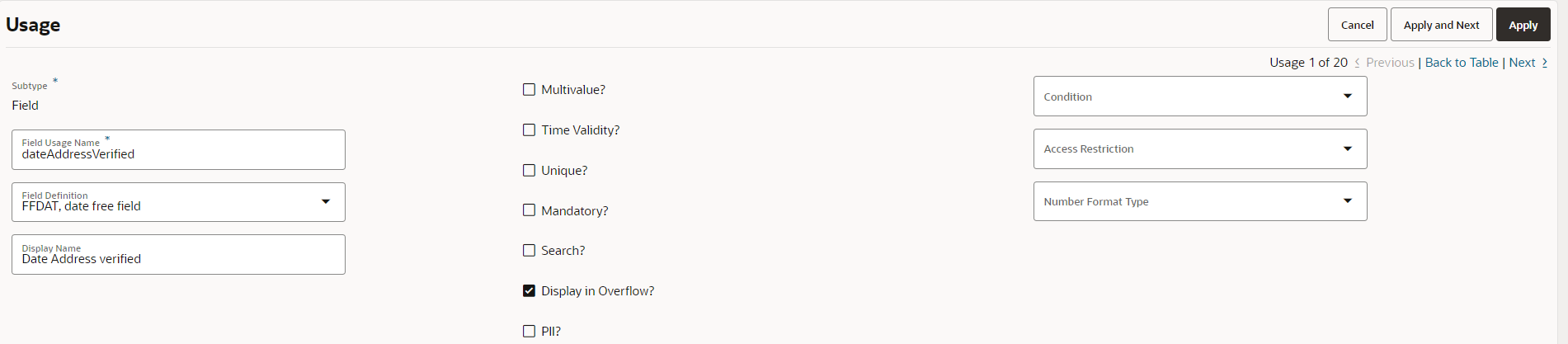

Adding Dynamic Fields and Records
A dynamic field usage is the link between a table (entity) and the configured dynamic field that extends that table. Not all tables can be extended.
Some tables that can be extended, can only be extended sometimes have limitations to the type of fields that can be extended with. For example, whether they could be time valid and whether the table supports details. A dynamic field usage has the following attributes:
| Field | Description |
Field Usage Name |
Logical identifier of the dynamic field usage in the context of a base table. |
Search in LOV? |
Should this dynamic field be searchable within the standard lov? |
Mandatory? |
Should a dynamic field always be specified for a record in that table? |
PII? |
The field or record contains Personal Identifiable Information (PII). |
Display in Overflow? |
This indicates whether the dynamic field can be displayed in the overflow area in a multi record block. |
Search? |
The field appears in the advanced search feature for the extended table |
In LOV? |
Should this dynamic field appear in the standard lov? |
Sub Type |
Field, Code or Record. |
Display Sequence |
The order of the dynamic field usage for a specific table as shown in pages. |
Table |
The table that is extended. |
Time valid? |
The dynamic field or record values are stored with a start and end date. |
Multiple values? |
The dynamic field or record can store more than one value. |
Unique? |
The value of the field must be unique across all records in the extended table. |
Start date |
The first date that a value can be set for the specified dynamic field. |
End date |
The last date that a value can be set for the specified dynamic field. |
Name |
The name that is used by interfaces and dynamic logic scripts. The name can be specified in mixed case, to support the coding conventions in use. The name for a dynamic field usage cannot be equal to the name of a native field or another dynamic field usage for the same table. |
Display Name |
The label of the field as shown in the user interface. |
Field |
The field that defines this dynamic field. |
Code Definition |
The single flex code definition or flex code set that represents the domain of allowed flex codes. |
Record Definition |
The dynamic record definition that defines what kind of records the table is extended with. |
Sequence |
Drives the placement of this dynamic field in standard user interface. |
Condition |
Determines whether a dynamic field or record value may be set. |
Mandatory Condition |
Determines whether a dynamic field or record value is mandatory. |
Number Format Type |
The format in which a numeric dynamic field can be displayed. |
Access Restriction |
Determines whether the access to the usage is restricted. |
Depending on the sub-type, a dynamic field usage refers to either a field definition, a code definition or a record definition.
Only usages for fields can be configured as unique. A dynamic field usage of the type Field cannot be both unique and have multiple values. The unique indicator can no longer be checked once actual values have been stored for that usage.
Once the usage has been created and the dynamic field has been set up to add a field to a floor plan, the Floor Plan Configuration page explains how to add a field to a floor plan to control what is displayed on the UI to the end user.
