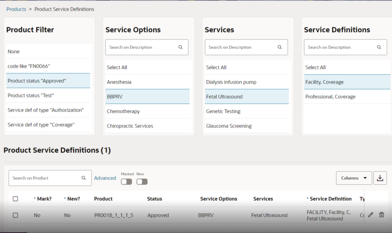

Product Service Definition Filters
The page holds four filter options:
Product
Service Option
Service
Service Definition
The final filter is the "AND" result of all four filters. The Product Service Definitions section only display those rows that comply with all four filters.
The filters work in combination with the quick and advanced search on the product service defintions. Each filter must have an option selected before adding extra conditions in the quick or advanced search.
Selecting an option refreshes the displayed results on the next filters automatically. This helps create logical combinations. For example, when selecting the Select All option in the service options filter, the services and service definitions filters also display all the options, including the Select All option.
Product
This filter limits the resulting product service definitions to those associated with the product(s) returned by the selected product pre-filter.
Filter the list of products by selecting a pre filter from the pre-filter list.
See Search Object - List View for steps to configure a prefilterList.
Example
Add a
prefilterListto the product service definition’s floorplan that has two pre-filters: "Approved Products" and "Not-approved Products".Pre filter list in the floorplan
{ "resource": "product", "floorplan_search_listview": { ... "preFilter":"", "preFilterList":[{ "descr": "Approved Products", "query": "product.status.eq("Approved")" }, { "descr": "Not-approved Products", "query": "product.status.neq("Approved")" }, ], "quickSearch": { ... } ... } } -
Filter the product service definitions with the search filters service option as BBPRV, service as Fetal Ultrasound, and service definitions as Facility, Coverage.
Do not filter the products, that is, keep the product filter to None. In this example the page displays the following results:Table 1. Product Service Definitions Without Pre-Filter Selection Product Status Service Option Service Service Definition Type PR001

Keep the search filters as specified above and select the "Approved Products" pre-filter. In this example the page now displays the following results.
Table 2. Product Service Definitions With "Approved" Pre-Filter Selection Product Status Service Option Service Service Definition Type PR003

Keep the search filters as specified above and select the "Not-approved Products" pre-filter. In this example the page now displays the following results.
Table 3. Product Service Definitions With "Approved" Pre-Filter Selection Product Status Service Option Service Service Definition Type PR001

Service options
This filter limits the results to product service definitions for a selected service option or to one of the Select All options. Selecting a service option from the service options filter limits the returned result in the services filter to services that reference the selected service option.
Services
This filter limits the results to product service definitions for a selected service. The Select All option includes all services displayed in the filter. For a selected service, the filter limits the returned results to all service definitions referencing a service definition for a selected service.
Service definitions
This filter limits the results to all product service definitions defined for the selected service definition. The Select All option encompasses all service definitions displayed in the filter. If a service definition is selected, then the filter limits the returned results to all product service definitions that reference that service definition.
