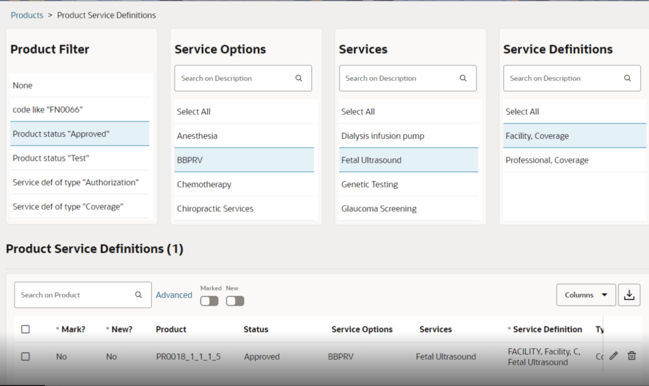

This page enables maintaining product service definitions across products. Often the same update to a product service definition needs to be applied to more than one product. This page enables such updates by allowing the user to search on and view the product service definitions of multiple products.
The page is divided into two areas:
  • An area to provide search dimensions used to limit the number of displayed product service definitions.
  • A product service definitions area used to configure the product service definitions contained in the products.
The system can contain a very large number of product service definitions. Provide enough filter criteria to limit the number of queried product service definitions to a maintainable set. A large result set may affect page performance.
Product Service Definition
Figure 1. Filtering Product Service Definitions across Products
Product Service Definition Filters
The page holds four filter options:
  • Product
  • Service Option
  • Service
  • Service Definition
The final filter is the "AND" result of all four filters. The Product Service Definitions section only display those rows that comply with all four filters.
The filters work in combination with the quick and advanced search on the product service defintions. Each filter must have an option selected before adding extra conditions in the quick or advanced search.
Selecting an option refreshes the displayed results on the next filters automatically. This helps create logical combinations. For example, when selecting the Select All option in the service options filter, the services and service definitions filters also display all the options, including the Select All option.

  2. Filter the product service definitions with the search filters service option as BBPRV, service as Fetal Ultrasound, and service definitions as Facility, Coverage.
    Do not filter the products, that is, keep the product filter to None. In this example the page displays the following results:

  3. Keep the search filters as specified above and select the "Approved Products" pre-filter. In this example the page now displays the following results.

  4. Keep the search filters as specified above and select the "Not-approved Products" pre-filter. In this example the page now displays the following results.

So what happened for the different products and parameter aliases?
  • The "Office Visit Copay" for the HMO product is updated. The existing parameter with the value of $10 is end dated and a new parameter is added because there is a partial overlap with the start date of the new parameter value. All parameter values before 1 July 2014 are retained. Note that the new parameter value also applies to the "PCP Visit" service definition for the HMO product that was not in the set of marked product service definitions. This is because the parameter value is set at the product level and not for the individual product service definition.
  • The "Office Visit Copay" for the PPO product is updated. The existing parameter value is removed because the start date of 1 July 2014 functions acts as a resend from date replacing everything after that date.
  • The "Office Visit Copay" for the POS product did not change. The Product Service Definition is not part of of the marked set, so the referenced product is not updated.
Update Applicable Cost Share
This feature allow user to update the parameterized columns for multiple rows at once by selecting the column and then selecting a value.
  • Updating the parameterized columns requires at least one row (means one product service definitions) to be selected, in case no rows are selected, display the following error 'There are no rows selected. Select table rows with the selection checkbox before applying this action
  • Apply button on drawer only updates the values in the table, page level save is required to commit the changes.
