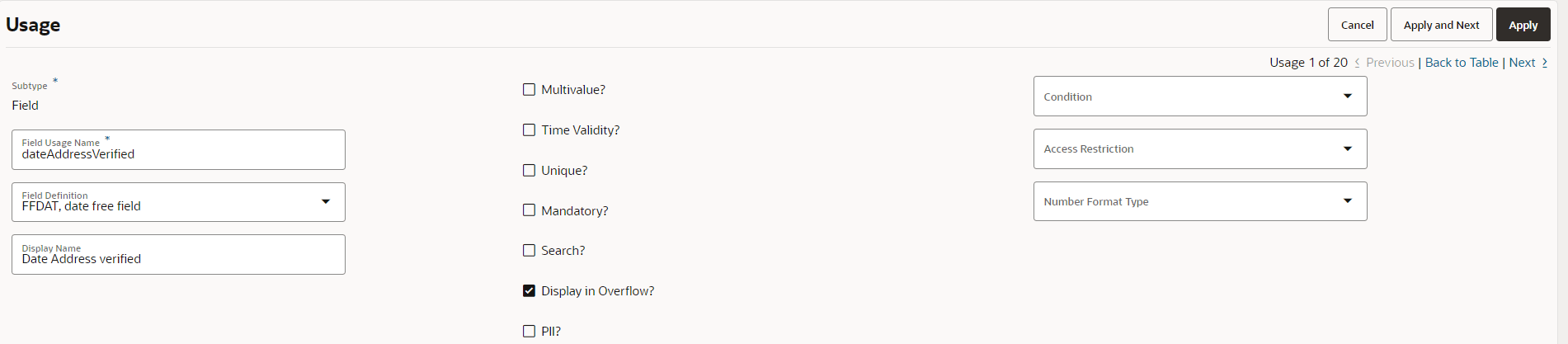

A dynamic field usage has the following attributes:
Table 1. Adding Dynamic Fields and Records
Field Description
Field Usage Name
Logical identifier of the dynamic field usage in the context of a base table.
Search in LOV?
Should this dynamic field be searchable within the standard lov?
Mandatory?
Should a dynamic field always be specified for a record in that table?
PII?
The field or record contains Personal Identifiable Information (PII).
Display in Overflow?
This indicates whether the dynamic field can be displayed in the overflow area in a multi record block.
Search?
The field appears in the advanced search feature for the extended table
For JET: Indicates if this field is searchable.
In LOV?
Should this dynamic field appear in the standard lov?
Sub Type
Field, Code or Record.
Display Sequence
The order of the dynamic field usage for a specific table as shown in pages.
Table
The table that is extended.
Time valid?
The dynamic field or record values are stored with a start and end date.
Multiple values?
The dynamic field or record can store more than one value.
Unique?
The value of the field must be unique across all records in the extended table.
Start date
The first date that a value can be set for the specified dynamic field.
End date
The last date that a value can be set for the specified dynamic field.
Name
The name that is used by interfaces and dynamic logic scripts. The name can be specified in mixed case, to support the coding conventions in use. The name for a dynamic field usage cannot be equal to the name of a native field or another dynamic field usage for the same table.
Display Name
The label of the field as shown in the user interface.
Field
The field that defines this dynamic field.
Code Definition
The single flex code definition or flex code set that represents the domain of allowed flex codes.
Record Definition
The dynamic record definition that defines what kind of records the table is extended with.
Sequence
Drives the placement of this dynamic field in standard user interface.
Condition
Determines whether a dynamic field or record value may be set.
Mandatory Condition
Determines whether a dynamic field or record value is mandatory.
Number Format Type
The format in which a numeric dynamic field can be displayed.
Access Restriction
Determines whether the access to the usage is restricted.
Depending on the sub-type, a dynamic field usage refers to either a field definition, a code definition or a record definition.
