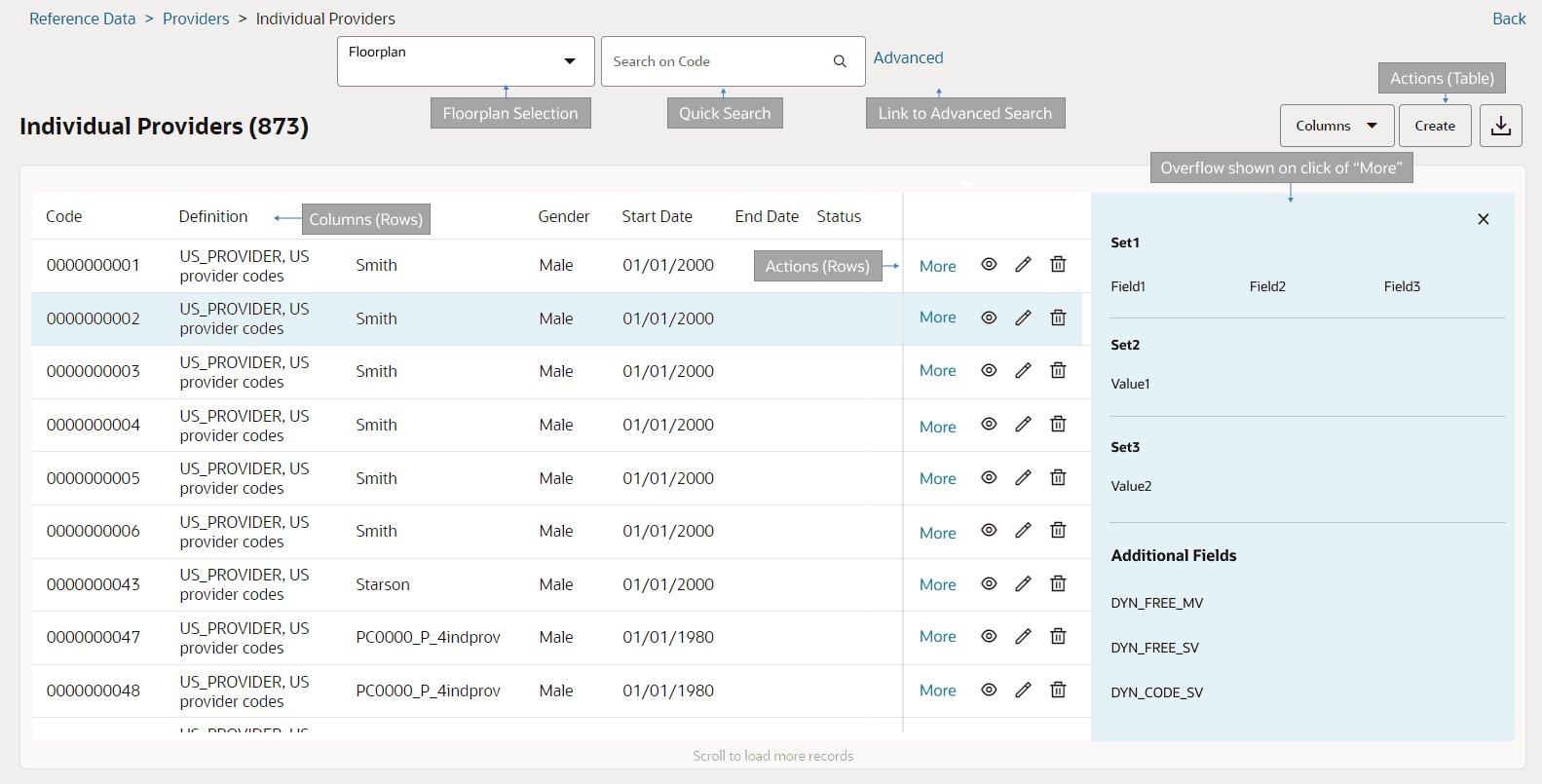

Page Layout
Search Object Table View Page Layout
Components
Pages using Search Object - Table View template has the following components:
Entity Name and Results Count
  • Non-configurable, default functionality
  • The entity name plural is displayed above the table. The total count is displayed next to it
  • The count is displayed only when the user has performed a search
  • If no results match the search criteria, the results component displays the message 'no rows were found'.
Floor Plan Selection
  • Search Object - Table View template supports multiple floor plans for the same page
  • The user can switch context with a drop-down button located next to the quick search input
Actions
  • Optional component
  • By default no action is available unless specified in the floor plan
  • Only 'Add' available at page level, action link 'Create' is displayed when defined
  • Re-directs user to the create object page (recursive) in create object mode
  • When more than one view and edit object plans are evaluated by the system, then they are all displayed as available options in the drop-down. A user selects one of the options and the create object page is displayed using the selected floor plan
  • If only one plan is evaluated, then the drop-down is not displayed and on selecting the action 'Create', system immediately opens the create object page using the evaluated template
  • For details on floor plan evaluation refer to the chapter "Presentation Configuration" in the Developer Guide.
  • Create as drop-down list - The floor plan description is displayed. The options are ordered based on the floor plan code ascending. Selecting a plan from the list, opens the create object page for the resource using the selected template
  • Example use case: To make a search table page view only, no actions are defined at page and results level
  • Optional Component
  • Links are placed next to create object action for pages where widgets are not supported.
  • Links are placed in card (tile), on the pages that support widgets.
  • For more details refer Links component
Auto Fetch
  • Optional property
  • Set true to auto fetch records
Pre-filter
  • The setting 'preFilter' takes in criteria that is executed for all the searches as 'and' condition
  • This limits the result set on which the search is performed
  • The filter conditions can be set using HTTP Query API grammar; for example, setting preFilter to
    integration.code.eq "PROVIDER_EXTRACT"
    for exchanges search page, will show exchanges having integration code equal to 'PROVIDER_EXTRACT'
  • Example use case: To limit the results based on the value of a field within the resource in case if multiple search table floor plans are defined
Pre-filter List
  • This component extends preFilter by enabling the user to select a criteria from the list, limiting the result set on which the search is performed
  • Filter options are shown as drop down before quick search and after available floorplanslist. The boilerplate text given by the Descr attribute is shown in the drop down list. The query linked to the selected filter option is added to the fixed criteria when searching within the resource list.
  • The filter conditions can be set using HTTP Query API grammar; similar to pre-filter
  • Example use case: To limit the results based on certain conditions within the resource in case if multiple search criteria are needed.
  • Center aligned
  • Can be customized to search on multiple attributes including flex codes, reference fields
  • For more details refer Quick Search component
  • Displayed as a hyperlink which displays the advanced search dialog
  • Enables search on a combination of attributes
  • For more details refer Advanced Search component
Sort
  • Displayed next to Actions when defined
  • Can have only the default or multiple sort criteria
  • For more details refer Sort Component component page
Filter
  • Filter criteria is defined to give users option to further filter the search results
  • A filter entry is used to restrict the search query, not to compose a new query
  • Example use case: Filter defined on a resource which can have multiple statues like completed, in-progress, started etc.
  • For more details refer Filter component page
Table
  • Required component
  • Used to display the search results in form of a table
Table component consists of the following sub-components:
Rows
  • All table properties are defined under rows and rows are configured with the following components:
Actions
  • View, Edit, Copy, and Remove are displayed for each row when configured.
  • Action Remove, deletes the object from the list.
  • A dialog seeking user confirmation Delete this record? with Ok and Cancel is displayed when this action is selected. Selecting Ok deletes the record.
  • When the record deletion is successful, a success confirmation message {object name singular} deleted is displayed as specified in the section Indicating Success of the Response Messages chapter in the Developer Guide.
  • If any messages are returned from the server other than success, then they are displayed on the UI.
  • Action View opens the View and Edit object page in the view mode.
  • Action Edit opens object page edit mode.
    • To edit a row inline, configure inlineEdit at the floorplan level. Once configured, the system displays an additional Edit action to edit the row inline.
      inlineEdit configuration applies only to the episodes page.
  • Action Copy opens the View and Edit object page in edit mode by cloning the object selected for copy.
  • The menu (…​) displays additional actions when more than three actions are configured for a row.
Columns
  • Each property defined in this section forms a column in the table
Labels
  • It is used to display property values in form of a label and can take in exactly one property per label
  • Multiple labels can be added to the results
Region
  • Used if additional properties need to be displayed for the row overflow region
  • The region will slide in from right hand side of table on clicking "More" link, with X (close icon) to close
  • Set 1 and Set 2: Sets are used to display multiple properties as a set. Each result can have up to 2 sets.
  • It is recommended to use only Set 1 when using the filter component on the page.
For more details see Table component page.
Pagination
  • Infinite scroll to load next page of records when scroll ends
  • Pagination component can be configured to display the page size of the table
