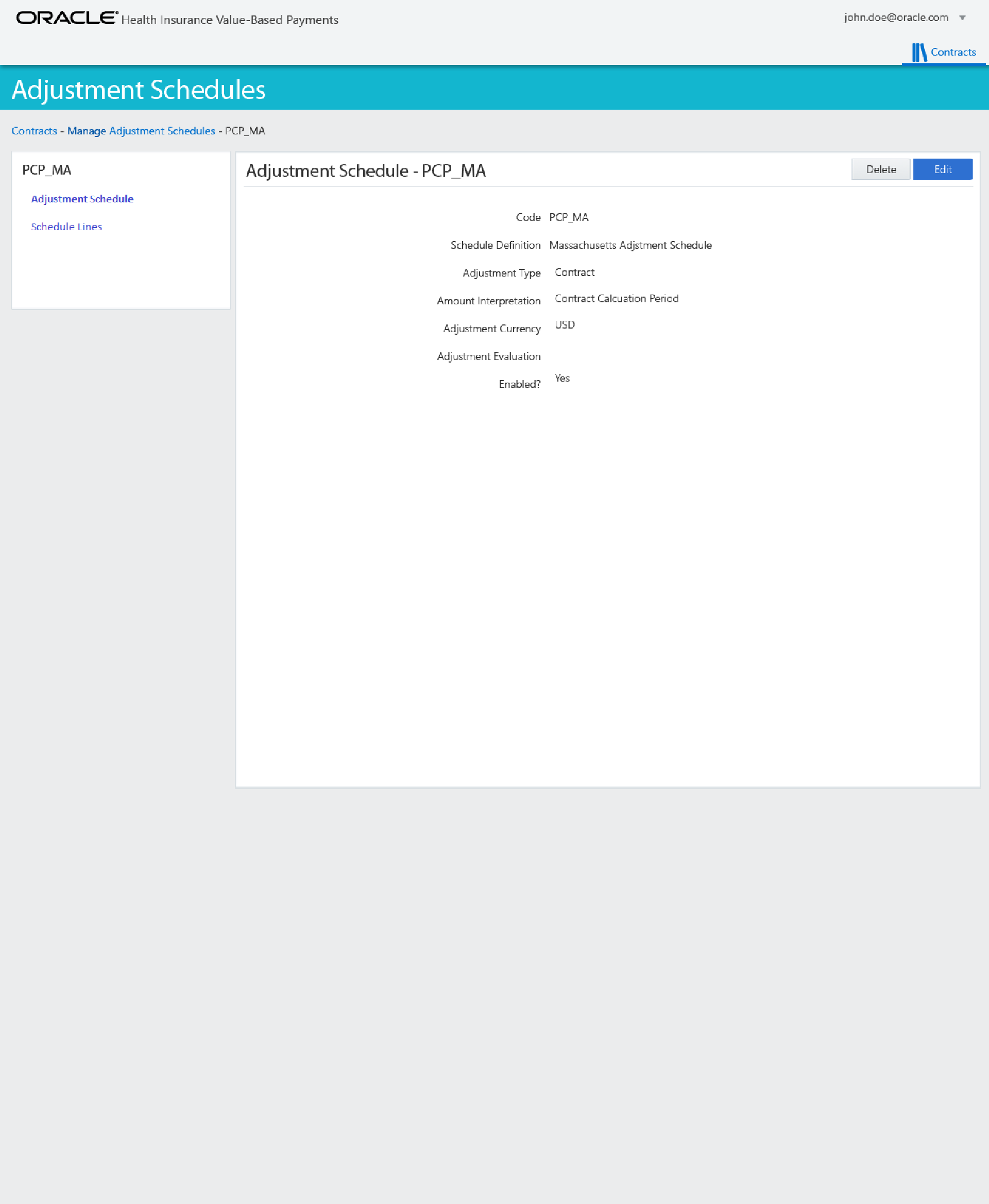

Adjustment Schedule Page
This displays a single adjustment schedule. The page can be accessed through the search page by clicking one of the search results or directly with the associated URL.
The adjustment schedule page displays the following links:
Adjustment Schedule
Schedule Lines
Adjustment Schedule
This page is the landing page and provides an overview of the adjustment schedule. It is possible for a user to view and edit adjustment schedule attributes here. It is based on the JET page template 'Hierarchical Recursive'. For more details on page templates, refer to the User Interface Patterns book.

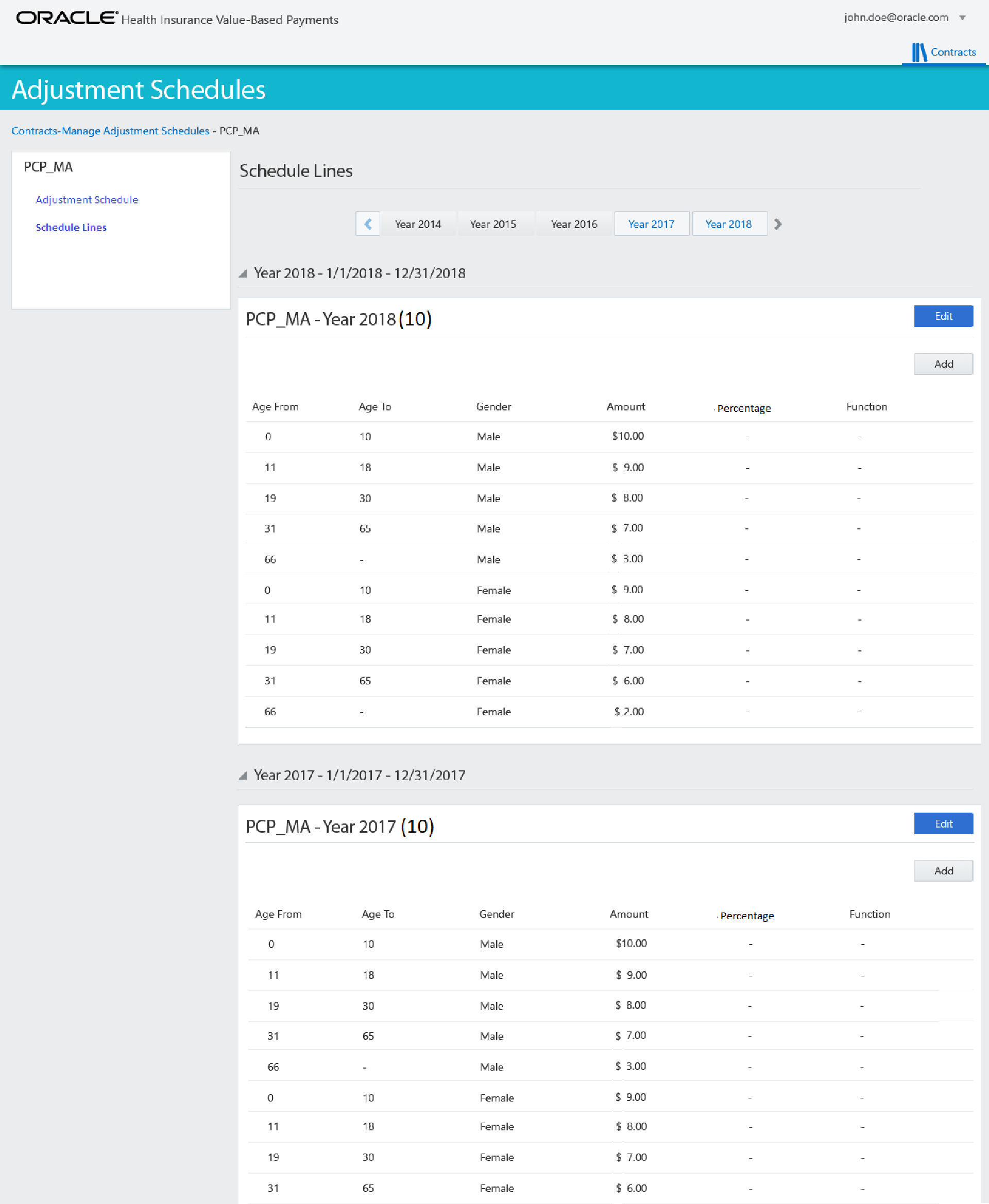

Adjustment Schedule Lines
| Member Age From | Member Age Through | Member Medical Condition | Adjustment |
N |
0 % |
0 |
18 |
Y |
20 % |
19 |
64 |
Y |
25 % |
65 |
Y |
30 % |
