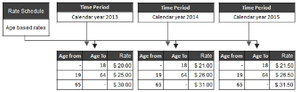

The image below shows a rate schedule that is updated once per calendar year. The default time periods each span a calendar year. Each line in the schedule applies to a single default time period.
The three schedules in the image represent three views of the same rate schedule, each for a different period in time. To the user, the rate schedule is presented within the context of a default time period, for example, the rate schedule for 2014. The user can switch between the different default time periods, going back and forth through time to see how applicable rates have changed. A default time period has the following fields:
