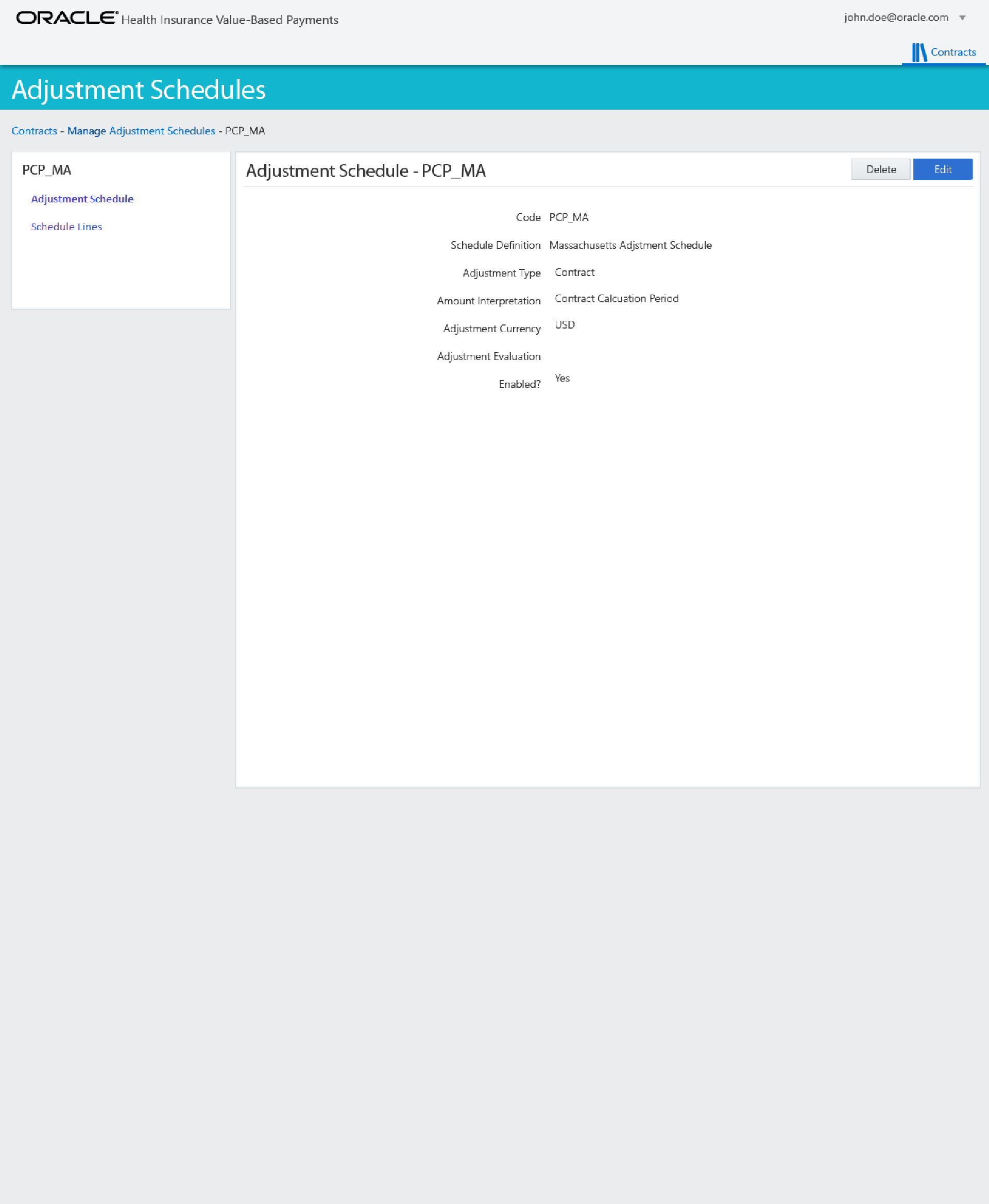

Adjustment Schedule
This page is the landing page and provides an overview of the adjustment schedule. It is possible for a user to view and edit adjustment schedule attributes here. It is based on the JET page template 'Hierarchical Recursive'. For more details on page templates, refer to the User Interface Patterns book.
Adjustment Schedules Settings

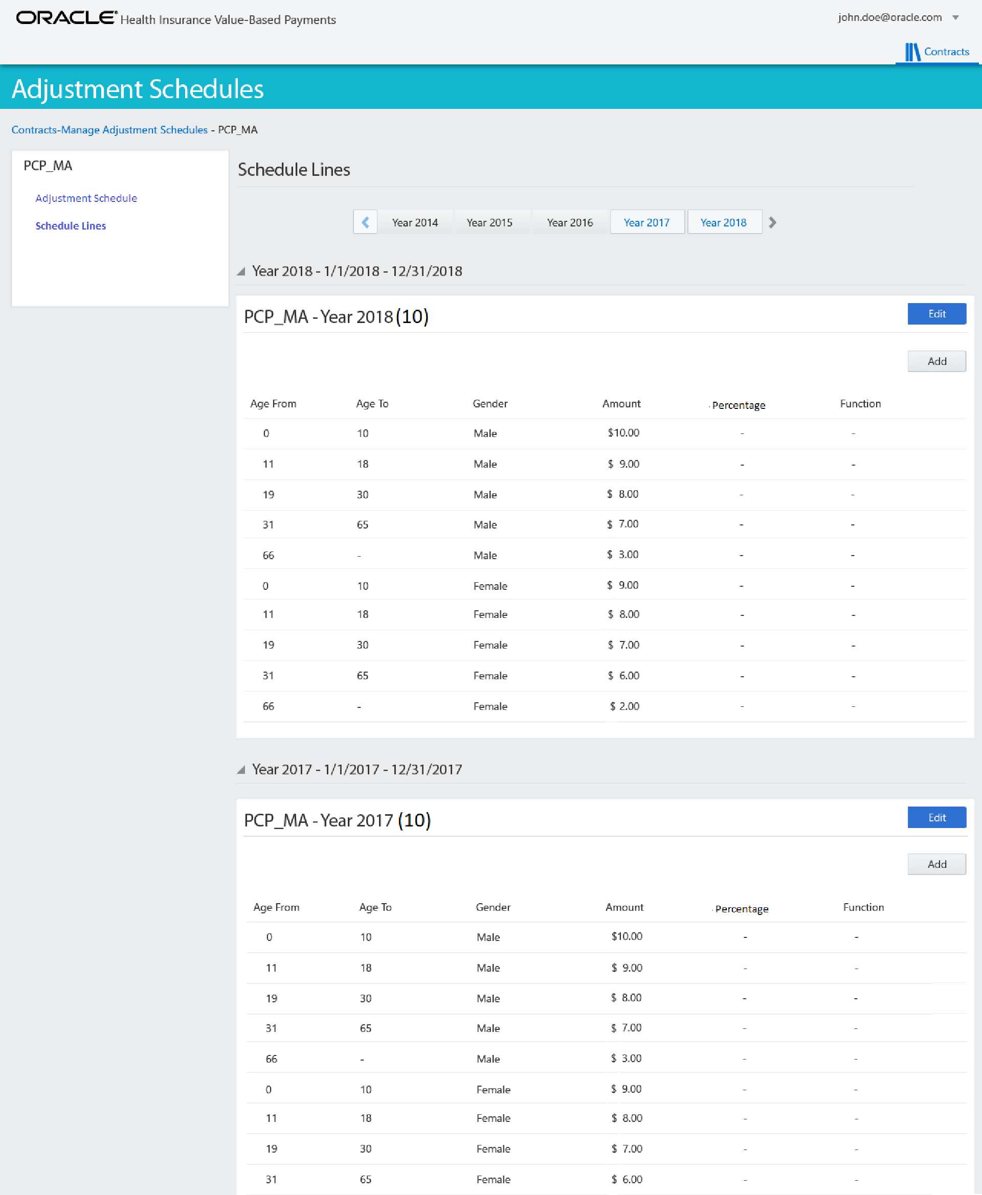

Schedule Lines
This page provides an overview of the schedule lines applicable within the context of the time periods. This section is similar to 'Schedule Lines' section in the rate schedule page. For details refer section 'Schedule Lines' of the chapter Rate Schedule
