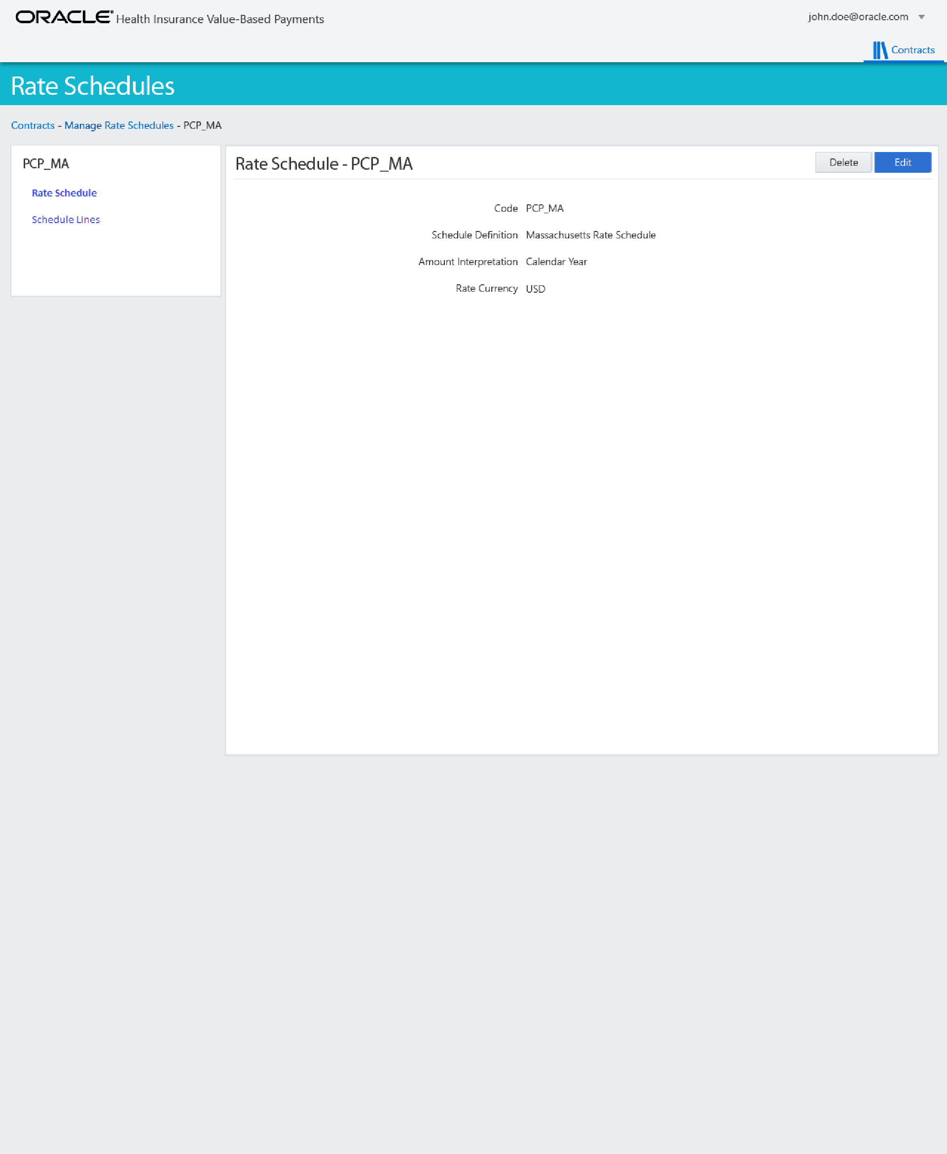

Rate Schedule Page
This displays a single rate schedule. The page can be accessed through the search page by clicking one of the search results or directly with the associated URL.
The rate schedule page displays the following links:
Rate Schedule
Schedule Lines
Rate Schedule
This is the landing page and provides an overview of the rate schedule. It is possible for a user to view and edit rate schedule attributes here. It is based on the JET page template 'Hierarchical Recursive'. For more details on page templates, refer to the User Interface Patterns book.

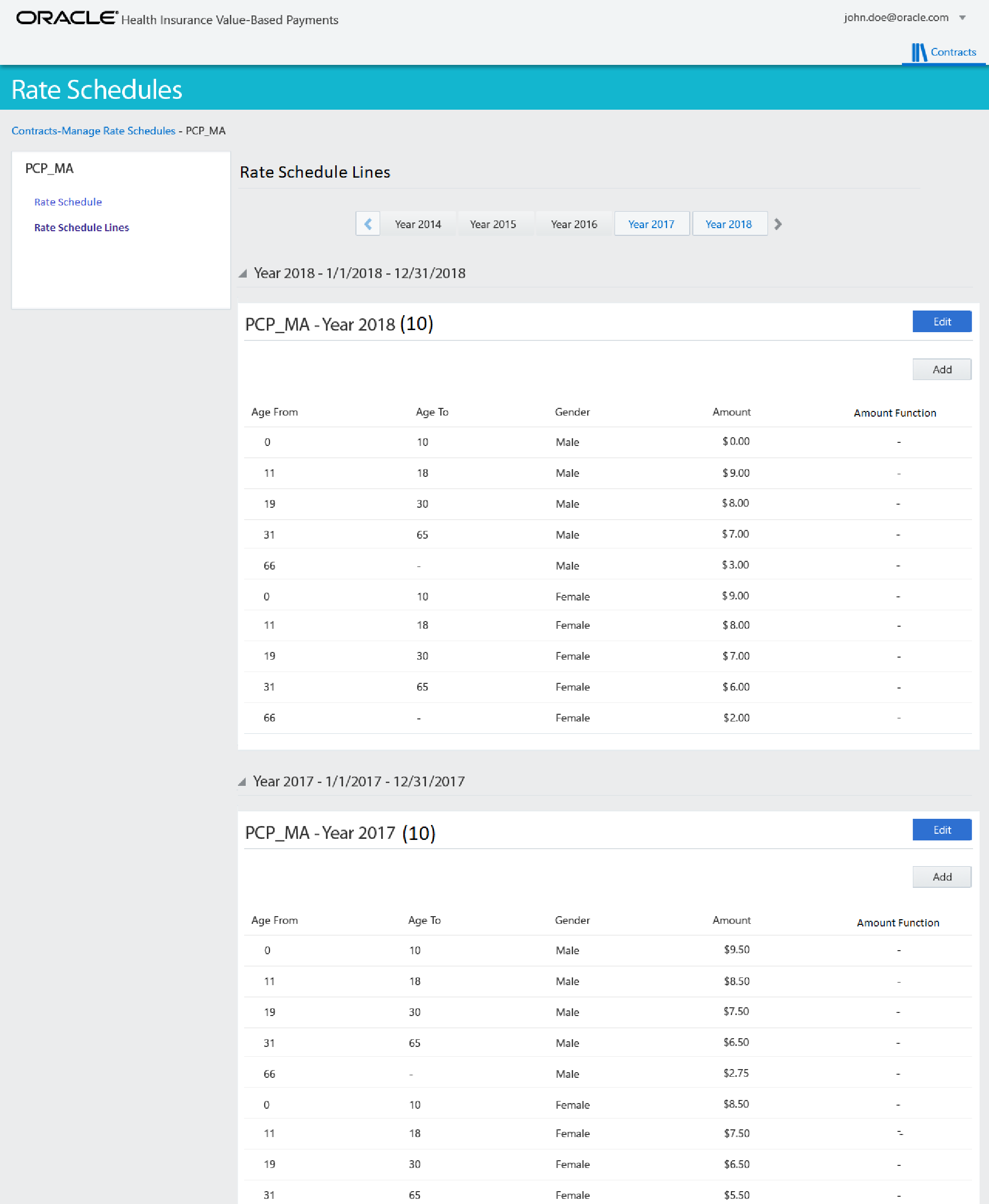

Schedule Lines
This page provides an overview of the schedule lines applicable within the context of the time periods.
The available time periods are shown using the Conveyor Belt pattern as described by the JET Cookbook. The list is ordered based on the time period start date (ascending) and the last five periods are shown.
For a selected time period, the next section shows the schedule lines that are within its context. This section is shown in the view mode by default. Action ‘Edit’ makes the section editable. The user can now edit the schedule lines.
- Comparing Schedule Lines
This page provides the ability to compare schedule lines within the context of different time periods.
Selecting more than one period, shows schedule lines within the context of the selected time periods. The schedule lines are bounded by a collapsible header displaying the time periods display name, start and end date.
The schedule lines section is closed when a user clicks on a previously selected time period. Note that if there are outstanding changes in the section being closed, then the user is prompted to either save or cancel the changes. The actions save and cancel are scoped only for the section that is being closed.
Image showing schedule lines over two different time periods being compared.
